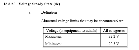

All Plasma CDI systems can be used with 12 or 24 volt electrical systems. Input voltages above 35 volts or reversed polarity will cause system dammage. |
Aha! A number. Okay, until we're offered different
values, we can work with the idea that DO-160 upper
operating voltage limits for 28v systems apply here . . .
[img]cid:.0[/img]

Summary:
If the ov trip on these systems is equal to or greater
than 32.2 volts, then installation in a 14v system
with switches and fuses should be no big deal. This
ASSUMES that the crowbar ov protection system has
no parasitic trip modes. We've encountered this
phenomenon a couple of times and instituted design
changes to mitigate the problems as they were
discovered.

perturbations . . . especially on positive excursions.
But look at this trace:
http://www.aeroelectric.com/Pictures/Curves/Safari_Bus_Noise_1.gif
This was taken from my GMC van and shows noises on the
bus on the order of 1.5 volts peak-to-peak. This was
measured AT the battery. A similar trace was delivered
by a measurement at the cigar lighter plug.
discovered.
