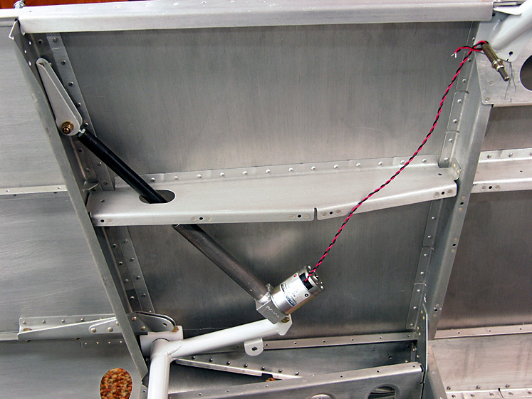

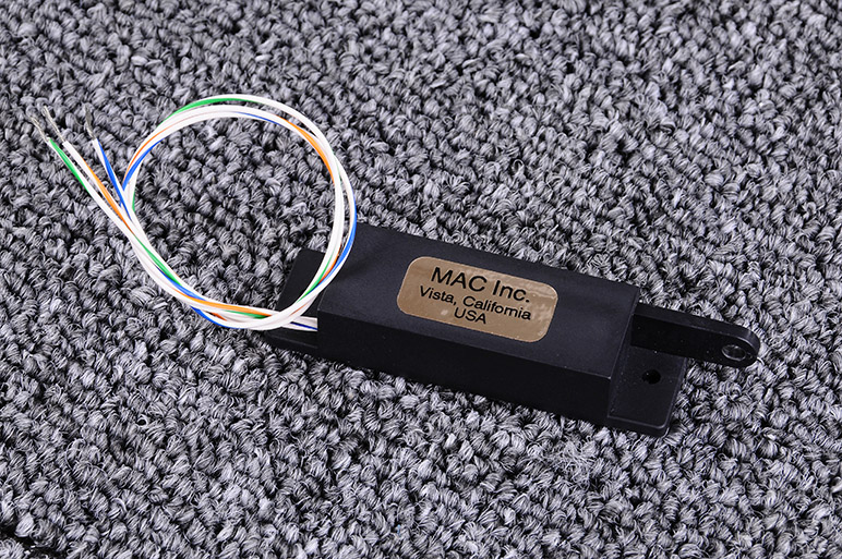

Does anyone have a simple, reliable installation design for the little position sensor from MAC Trim when used with the Electric Flap option on the PP QB RV-8? I've scratched my head for few hours now and have some ideas, but nothing that really seems like its simple enough or not prone to jamming. What have other builders done? Pictures would be great!

While Dave and I did not utilize a MAC flap indicator on our 8 C we did install a micro switch for our AOA (now Advanced Flight Systems) to toggle between cruise and landing configuration. We utilized a micro switch that activated at 20 degrees flap extension. It was a simple bracket located on the opposite end of the flap weldment ( right side of the bracket - facing forward). Before Jim Frantz sold his AOA company to Advanced Flight Systems there was a picture of the installation. You might call Advanced and see if they still have a copy of the installation jpegs or le me know and I'll try and find it.

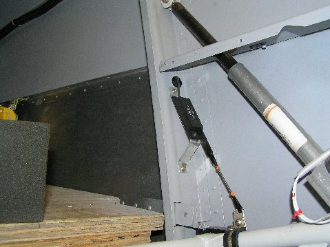

Matt, I simply bent a piece of scrap Al (025 or 032??) to mount my POS-12. Since the screws fastening the support to the bulkhead were inside of the baggage wall (between the baggage wall and the fuselage skin), I used #6 nut plates (for future service). In addition the termination of the wires (pins and barrels) are on the fwd side of the bulkhead (in case I needed to change out the sensor in the future... old photo during construction). You'll need to adjust the length/position of the threaded rod/clevis for the appropriate travel
Pretty simple and has worked well on my AF2500.

Forgot the photo, sorry.
