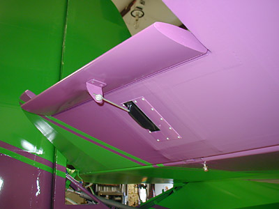

Paul, Lowell made that "nifty cover" for the trim servo. As mentioned earlier I have one of his first systems and have installed the trim button on the stick. It is similar to the T-28's I used to fly and sure makes it nice on approach. It was easy to string the wires. I used model airplane servo connectors to connect the wires which worked out well. Here is a picture of the elevator after painting prior to installation.

Paul C Lowell made that "nifty cover" for the trim servo. As mentioned earlier I have one of his first systems and have installed the trim button on the stick. It is similar to the T-28's I used to fly and sure makes it nice on approach. It was easy to string the wires. I used model airplane servo connectors to connect the wires which worked out well. Here is a picture of the elevator after painting prior to installation.

How thick is the servo? I think I can get one possibly almost completely under the
fabric on my elevator. I'll have to cut the trailing tube in one section of my
elevator then weld one back in with the hinges for the trim tab.
I'd be interested in having Lowell make the actual trim tab. I'd rather buy the tools
than pay the shipping of my elevator both ways.

| Quote: | How thick is the servo? I think I can get one possibly almost
completely under the fabric on my elevator.
I'm not familiar with the unit that Lowell is selling but I got one
from Murle Williams and it fit completely inside the tubing and
fabric. It just had a small protrusion where the rod came out of the
servo assembly.
