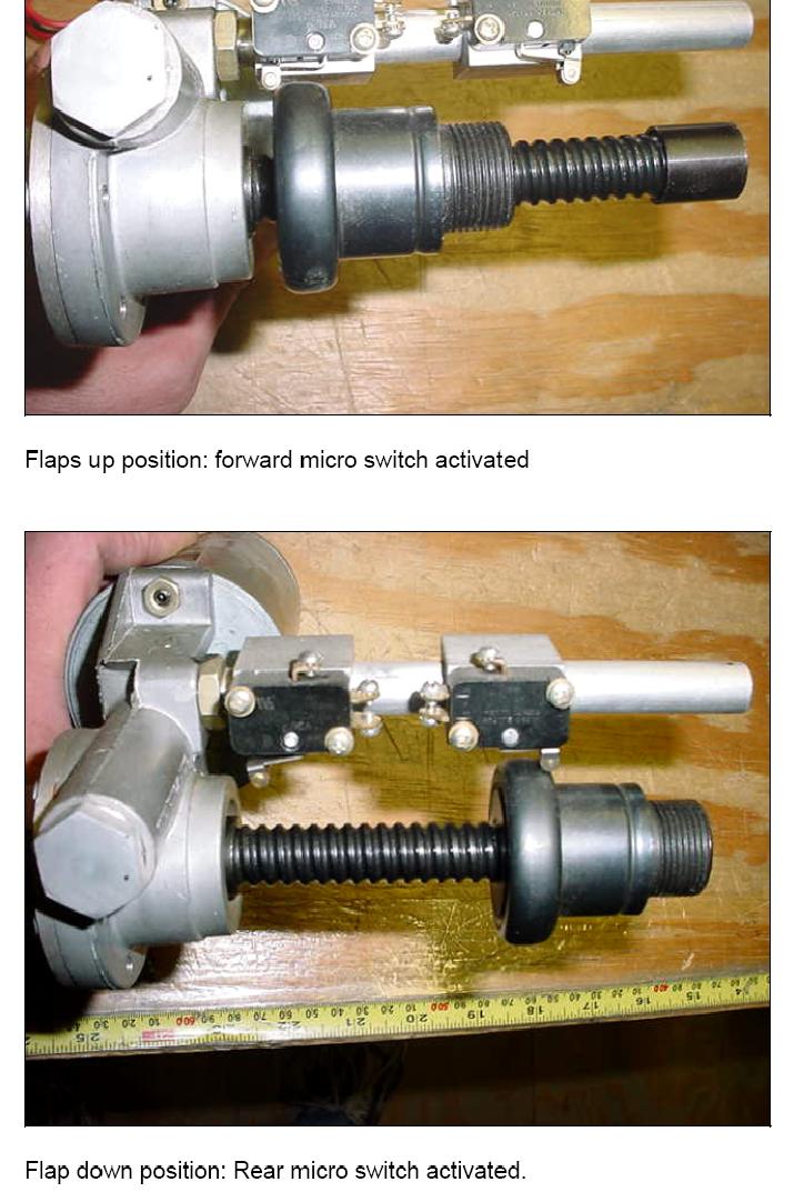

craig(at)craigandjean.com
PostPosted: Mon Nov 10, 2008 3:36 pm    Post subject: Amperage draw Reply with quote
Attached is a snapshot of page 9 of the photo guide for 6-B-19 (rev 2, 8/18/05). The rubber wheel depresses the roller on the limit switch. If the rubber goes beyond that it overstresses the switch. Unless you add some sort of external stops I don’t know how the stock motor supplies an adjustable mechanical stop.
One advantage of the Ray Allen flap rocker switch over a conventional DPDT switch is that the two internal micro-switches short the motor leads together in the off/center position. This causes the motor to act like a brake. Just make sure you order RS2-5 for the 5 amp version:
http://www.rayallencompany.com/products/switches.html
“The RS2 rocker switch provided with your Ray Allen trim system is designed to electrically short the servo motor to ground (-) when released. This stops the output shaft without any coasting, allowing precise positioning when trimming your aircraft. The RS2 rocker switch is rated at 1 amp.”
(http://www.rayallencompany.com/RACmedia/instructionsT2andT3.pdf - page 2)
-- Craig

PostPosted: Mon Nov 10, 2008 7:00 pm    Post subject: Amperage draw Reply with quote
  I adjusted my flap limit switches to shut off just very slightly after the flap hits the stop. This puts a slight twist pressure on the flap to keep it rigid in flight. I popped several fuses (15 A.) during the adjustment process. As soon as the motor is stalled, the load is too great. I've had no problems at all with it in flight.
