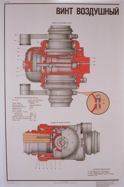

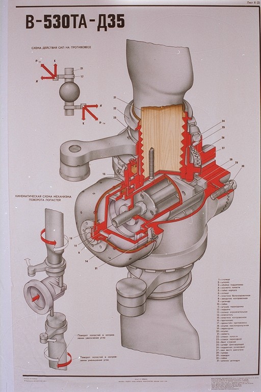

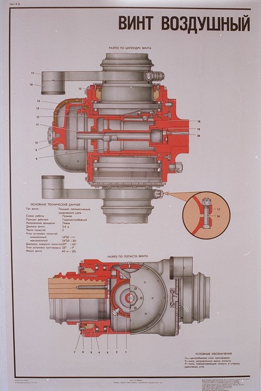

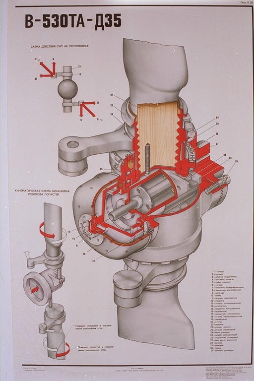

Anyone out there that might have a V530 prop hub manual with an exploded view of the hub they can send me. Purchased a Hub a while back and appearently, I'm missing some pretty important parts, but need to identify them first. Any help would be appreciated.

See if these will help Larry.
