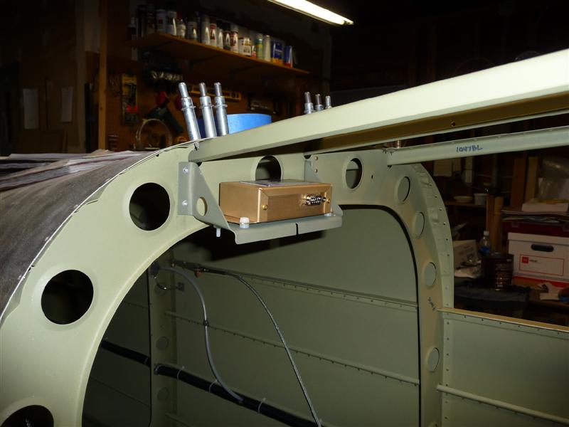

Posted: Thu Oct 09, 2008 8:24 pm Post subject: Mounting GRT AHRS & Magnetometer |
I can't say how well it works but I'll show pictures.
I fabricated a lightweight shelf using .040" aluminum to attach to the
bulkhead behind the baggage wall. I attached it with aluminum pull rivets
and used nylon lock nuts and bolts. The only concern I have is the weight
on the bulkhead and possible vibration while in flight. The magnetometer
and shelf together are very light so it shouldn't be an issue. I suppose I
could fabricate a bracket to support the bulkhead to the skin above but I
haven't done that and I don't really think it's going to be necessary.
The seat belt cables are not ferrous metal. They don't attract a magnet so
they shouldn't influence the magnetometer at all.
Here's a thread on AFS's forum with some more information including a shot
of Rob's dual install which he says has worked w/o incident.
http://www.advanced-flight-systems.com/forum/viewtopic.php?t=10

jesse(at)saintaviation.co Guest
Posted: Fri Oct 10, 2008 4:11 am Post subject: Mounting GRT AHRS & Magnetometer |
That location, in my experience, works very well. Nice fabrication.
I have used aluminum nutserts/rivnuts and stainless screws to mount
here, which is much easier to remove than having to hold a nut and
unscrew a bolt.

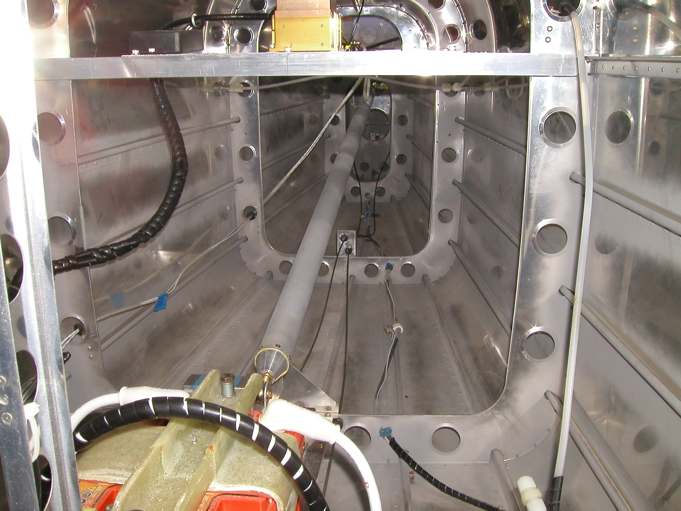

Posted: Fri Oct 10, 2008 5:07 am Post subject: Mounting GRT AHRS & Magnetometer |
This setup works well also.

MauleDriver(at)nc.rr.com Guest
Posted: Fri Oct 10, 2008 7:04 am Post subject: Mounting GRT AHRS & Magnetometer |
That is similar to what I was thinking about. I assume you have an
autopilot servo and since you are flying, it must be far enough away. I
was thinking of going a little further back.
I'm curious, whose unit is that? AHRS and Magnetometer or just one of them.

Real nice bracket - I'm afraid I can't easily produce something quite
like that but it's in a great location. How did you level it?
Ben Westfall wrote:
| Quote: | I can't say how well it works but I'll show pictures.
-Ben Westfall
#40579
| Back to top |
| Back to top |
dlm46007(at)cox.net Guest
Posted: Fri Oct 10, 2008 9:05 am Post subject: Mounting GRT AHRS & Magnetometer |
I use the Digiflite II and distance does not seem to be a problem. The gold
box is a Crossbow AHRS including magnetometer and GPS; it is used with the
Cheltons although I believe it is also used with AFS and Optech. The black
box is the GRT magnetometer for the Sport which has its own internal AHRS
with the display unit.

rv10(at)sinkrate.com Guest
Posted: Fri Oct 10, 2008 2:07 pm Post subject: Mounting GRT AHRS & Magnetometer |
It was a PIA to make cause I don't really have the equipment for it either.
I laid out a bunch of lines on the aluminum and cut out the shape on the
band saw. Cleaned things up with the wheel and lots of filing then used my
hand seamers from Avery to make the bends. That's why there is a relief cut
in the middle of the shelf as the hand seamers are only 3.5" wide so I bent
the front support in two separate bends. The shelf has a 7 degree downward
tilt to match the backward tilt of the panel.
I leveled the fuselage on the stand across the door sills (which levels the
panel) using a precise carpenters level. I drilled only one attach hole
through the bracket to allow me to pivot the bracket up/down until it was
parallel with the fuse then drilled another attach hole, clecoed, then
drilled the rest. The tilt of the bracket was within 1 to 2 degrees of the
panel. I used some plastic nylon washers to make them closer.
All together took several hours on a couple of different days.
-Ben
