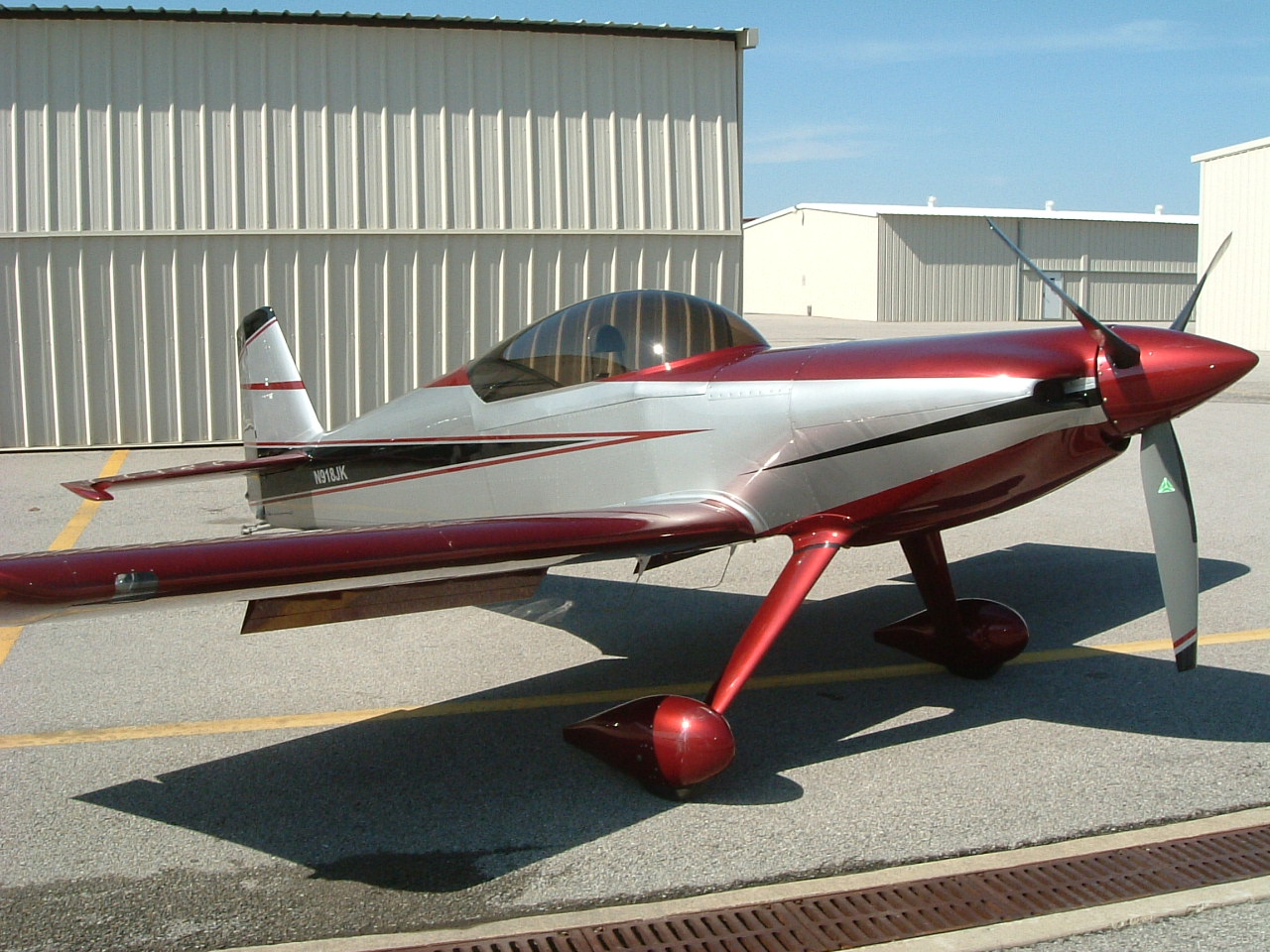

Please don't pull that cowl for me. I await your confirmation. BTW, send me a pic of yours so I can put a name to a Rocket.
Jim Stone
PS Attached is a pic of my ride

Lee Logan
Joined: 10 Jan 2006 Posts: 86
Posted: Wed Oct 08, 2008 1:54 pm Post subject: Airfilter problem |
Jim: Your Rocket continues to amaze... It's really beautiful!
Lee...
