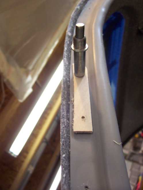

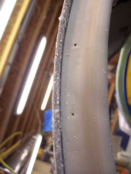

I found that when I installed the Vans seals per the illustration (Page 45-17, figure 2) the door fit was negatively impacted by the seal. Both doors now stuck up above the cabin lid. I ripped out the seals and replaced them with new Van's seals, but this time I placed the seal so that the lower edge of the seal flange fit snugly against the door wall (all the way down, in figure 2). During cure, the Van's seals were held in place with pieces of mixing stick (reduced in width). This worked much better.
Photos attached.
