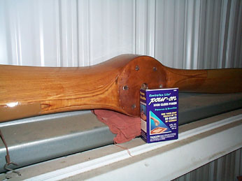

owenld(at)earthlink.net Guest
Posted: Wed Sep 10, 2008 4:19 pm Post subject: prop |
Gordon
This stuff won't keep the stone pits away but it works nicely for regular prop finish.
I got mine at the hardware store.
Lou Owen
Posted: Wed Sep 10, 2008 4:25 pm Post subject: prop |
http://eti-usa.com/consum/envtex/envlite.htm
Address for Pour On.
Lou
