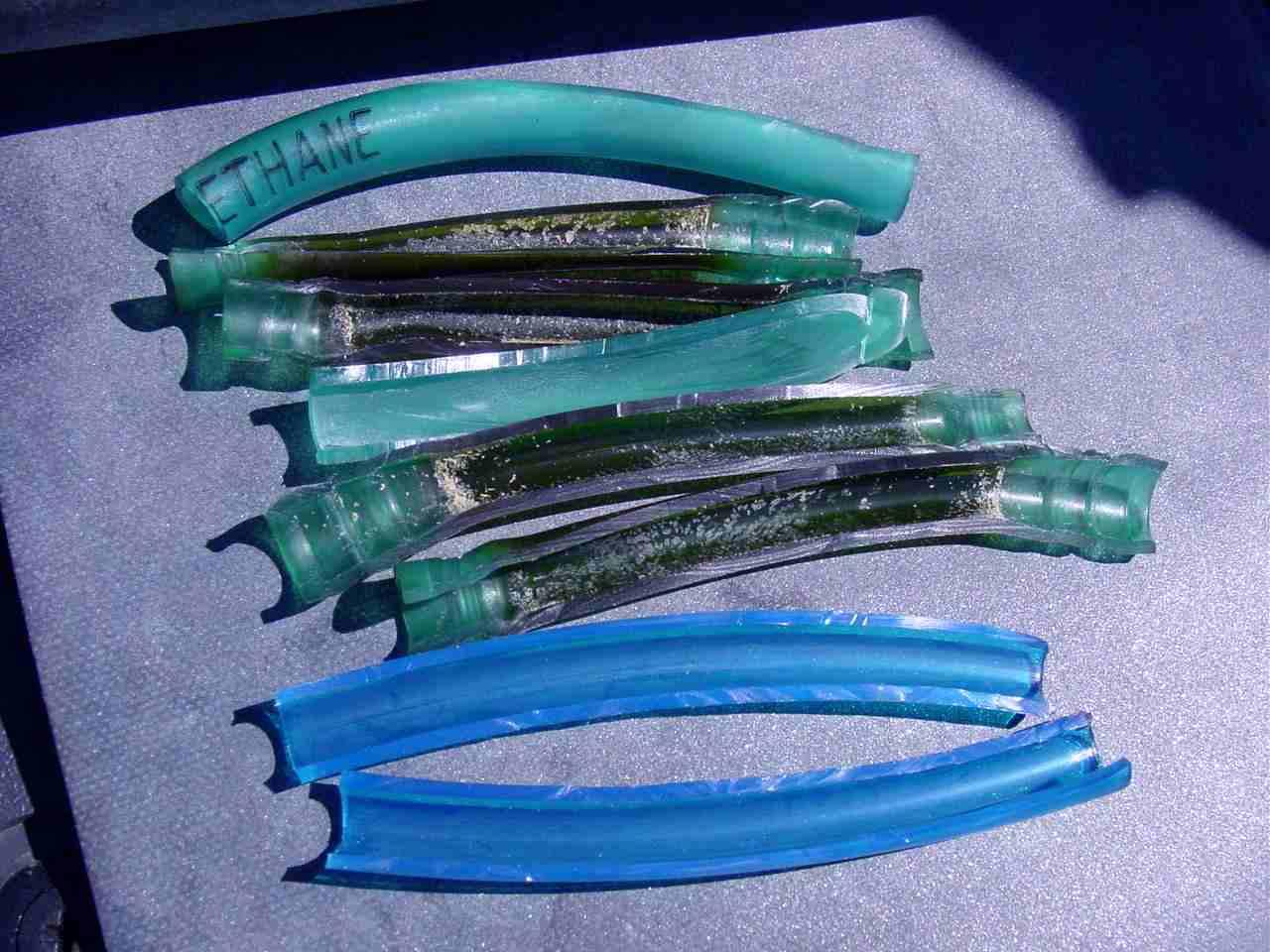

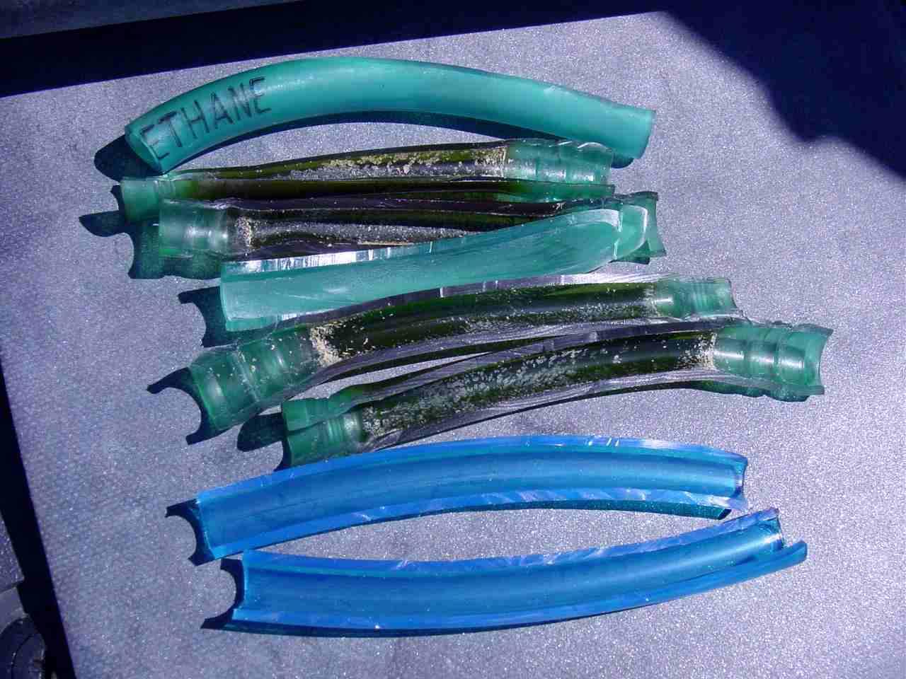

Had an interesting experience with the blue Bing down here... In service, it became the Brown Bing... and in some instances, the Black Bing with a brown furry side dish after about 5 months on the job. The puzzling aspect of the situation was that the clear Tygon fuel line pieces installed in the same system for the same period of time yellowed a little, but remained clean and unaffected inside. They were still soft and flexible. The attached photo shows the strange deterioration of the blue line, along with samples of the new blue stuff from the same batch of the corrupted Bing line and another batch of blue line obtained from another source.
I have no idea what caused this. I use only Amoco Premium gas and PZ air cooled oil. I changed out the lines with clear Tygon and have had no recurrence of this problem
brown furry side dish after about 5 months on the job...
Interesting. The blue line that was on my Ultrastar when I bought it
looked like that, but I don't know how old it was. OTOH I have some blue
line on one of my PPG's and several years later it looks and feels just
like new.
I wonder if it's not chemical, but UV damage that does the clear tubing in?
