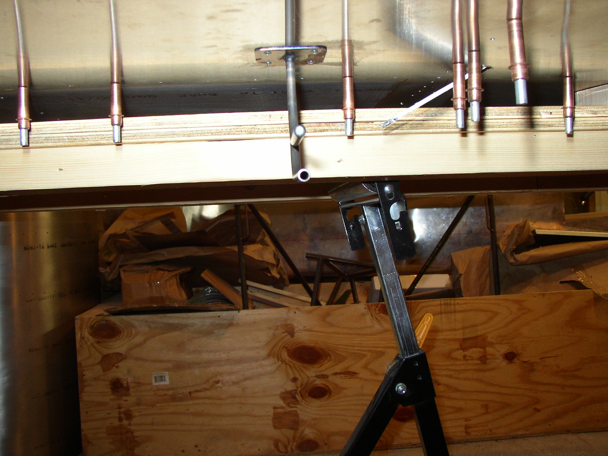

A while back I ordered a pitot tube from ZAC. They provided a pitot and static port unit which I believe is standard on the 601. I'm not sure how accurate the static port position is since I'm not flying yet.
This isn't a great photo. If you need others, let me know and I'll snap a few more next time I'm at the hangar.
