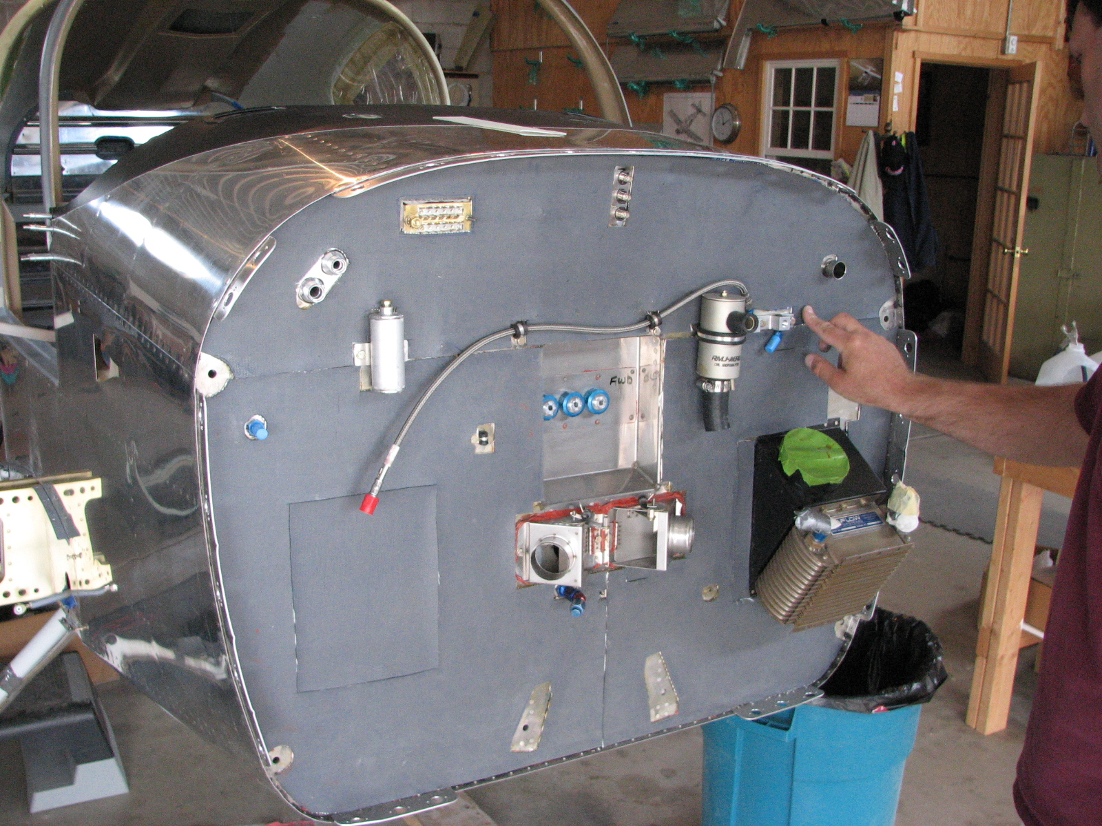

We have installed Kool Mat from Aircraft Spruce. Not flying yet, so
can't report on it. It is pretty heavy stuff, but that is probably a
good thing in our case since we have the air conditioner behind the
baggage compartment.

Sorry that photo link did not work. Hopefully this will.
