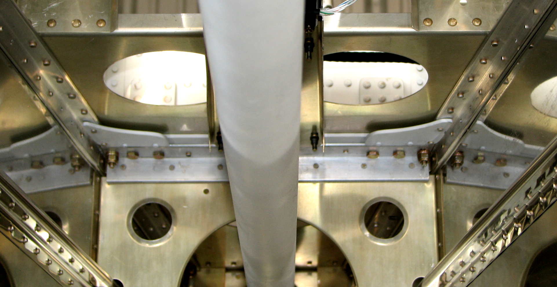

Over a year ago, while working on the emppange, I installed a gusset on each side of the same area in question in the SB. Can someone take a look at what I did and comment as to whether this should take care of the problem? Thanks guys.
Don McDonald
#40636 - finishing the finishing
