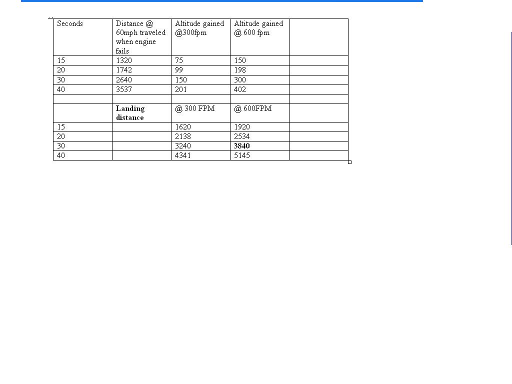

Here is my argument that having more engine power will not necessarily save you.
Say we have 2 Kolb firestars one with a 503 and one with the Generac.
Plane 1 with rotax climbs at 600 feet per min
Plane 2 with Generac climbs at 300 feet per min.
Flight conditions:
Runway is 3600 feet long with 80 foot trees 150 off the end.
Ground/ climb speed is 60mph
Glide ratio is 4:1
Engine quits 15, 20, 30 and 40 seconds after takeoff.
At 30 seconds the 503 would put you in the trees and the less powerful engine would allow you to land on the runway.
See the attached chart.
I really over analyze things sometimes Rolling Eyes
 Filesize:  49.49 KB
 Viewed:  434 Time(s)

At 30 seconds the 503, by your data, would be at 300 feet agl. At this height, it may be possible to do a 180 and get back to the runway. ???

Grant:
Your statement from your earlier post said it all.....
grantr wrote:
An engine out at 300 feet is an engine out at 300 feet..
Then you wrote.......
<<<<SNIP>>>>
Next you need to plug in a reliability factor to determine at what point each engine "might" fail after going to WOT. Don't forget to consider OAT, DA, age of fuel, age of pilot (reflex time), etc.... etc.... etc....
George Alexander

PostPosted: Fri Jul 18, 2008 8:48 am    Post subject: Re: Generac engine test data on my FS II Reply with quote
grantr wrote:
The very poor climb rate with the Genrac engine leaves you very vulnerable on takeoff, if you lose the engine on takeoff you will find yourself much lower, and with less landing options than you would with the 503 or with the HKS.
Not true. Either engine could stop at the same altitude. Climb rate just changes the time it takes to get to a certain altitude. An engine out at 300 feet is an engine out at 300 feet. Wink
You are wrong about this Grant R,
With a good climb rate, if your engine quits over the end of the runway you are much higher than you would be with less climb. Lets say your engine quits at the end of the runway, would you rather be 200 feet high, or 600 feet high ? That extra altitude would make all the difference in the world in landing options and safety.
To make matters even worse with a low climb rate, you are totally Dependant on your engine running for a much longer time to achieve a safe altitude if your engine quits. Lets say you want at least 500 feet AGL to have a chance at being able to make it to a good place for an engine out landing. With good climb performance, you may only need your engine to run perfectly for 30 seconds to be at 500 feet and have good landing options. With poor performance, you are totally Dependant on the engine running for over a minute to get to the same altitude. Getting to altitude quickly is much safer.
Lastly on power, having lots power to get out of trouble quickly is a proven safety advantage. There are a million unexpected things that can happen in aviation where having lots of power can save you. No one ever plans needing lots power to save their butts, but schit happens.
Mike
That seems too low to do a 180 by the time you get setup for an approach.
I do not disagree with this. However as I pointed out in my post at a certain point more power could put you in the trees where less power could have allowed a landing on the remaining runway.
True unless you are doing a steep rocketship climb out and the engine quits at low altitude and a high nose up attitude. That could lead to a deep stall and possibly a lawn dart. As you know a very steep climb out at low altitude can result in a deep stall and a unrecoverable dive into the ground if the engine fails at the right time.
