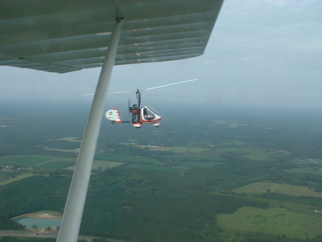

I was intercepted today by AF gyro.
just kidding
Gyrocopter flew with me to Alma today on my first cross country in my Kolb Mark II Twinstar.

Just curious.... Could he "keep up" or did you have to back off the throttle?

That's looks like a Sparrowhawk, and they normally cruise in the 65-70mph range.

Mike, My climb rate is MUCH faster, but as far as cruising he can keep up or even pass me. On the way there I was cruising at 65 but on the way back I cruised at 60 to save on gas.
It is a RAF 2000 gyrocopter.

Does that RAF have a horizontal stabilizer on it? If it doesn't don't fly in it. That particular gyroplane has killed many high time pilots. Its unstable without the H stab on it.

grantr wrote: | Does that RAF have a horizontal stabilizer on it? If it doesn't don't fly in it. That particular gyroplane has killed many high time pilots. Its unstable without the H stab on it. |
Grant,
Now you're delving into what has been "discussed to death" on threads and threads of gyro forums. I won't go there. I just know that I totally trust riding in that gyro and totally trust who is flying it.
Thanks for the concern.
