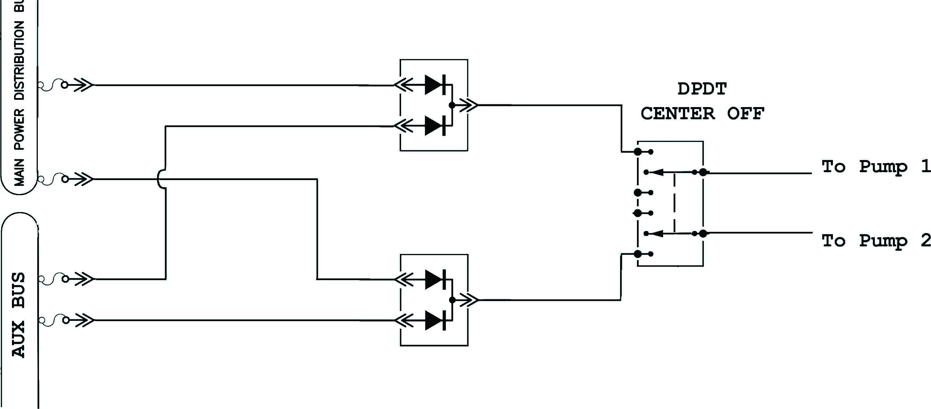

PostPosted: Mon Jun 16, 2008 5:58 pm    Post subject: Two Fuel pumps Z-19RB Reply with quote
Sam,
How about the attached circuit? Four fuses are necessary in case a pump shorts out and blows two of them. The switch is still a single failure point. It would be better to tolerate two pumps running at once. It would seem that regulators should be available to handle the flow rate of two pumps. If you do not want the voltage drop of diodes, two of SPDT switches could be used instead of diodes. The more complicated the circuit, the greater the chance of something going wrong.
Joe
