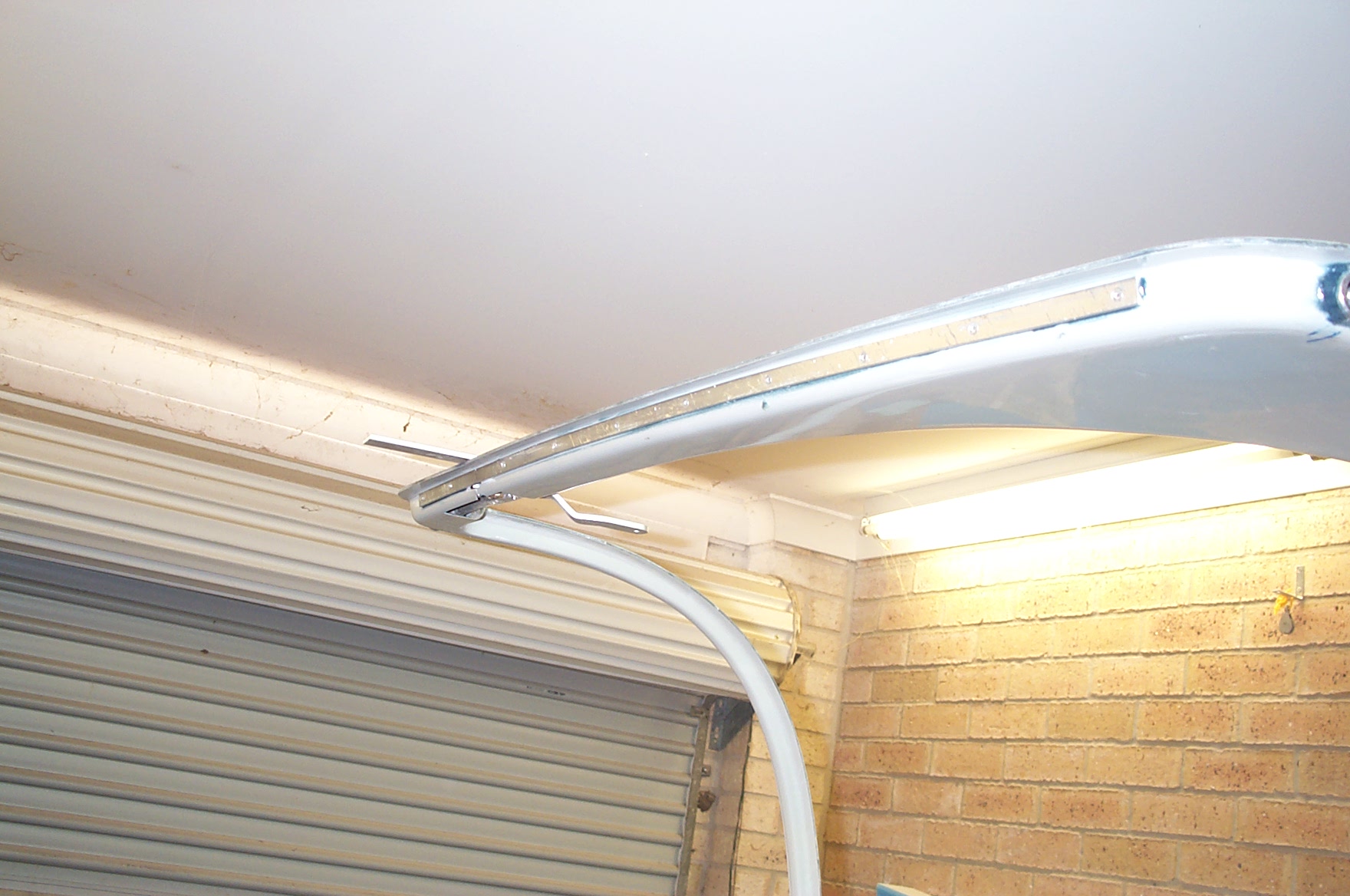

Posted: Mon May 12, 2008 5:29 pm Post subject: Door bulge because of seal |
| Quote: | Well here is my fix for the bulging doors, a piece of 3mm x 12mm alluminium
reduxed and flush rivetted, clears the door sill by about 3mm, door was
slightly over flattened with a straight edge and clamps alloy bent to be about
3mm flatter than the curve through the door opening. doors are now even and flush
right along the opening with seals in place. Overall weight increase 80g per door.
craig

4 or 5 plies of UNI carbon would have worked too
Graham
craig bastin wrote:
| Quote: |
*Well here is my fix for the bulging doors, a piece of 3mm x 12mm
alluminium*
*reduxed and flush rivetted, clears the door sill by about 3mm, door
was*
*slightly over flattened with a straight edge and clamps alloy bent
to be about*
*3mm flatter than the curve through the door opening. doors are now
even and flush*
*right along the opening with seals in place. Overall weight
increase 80g per door.*
*craig*
