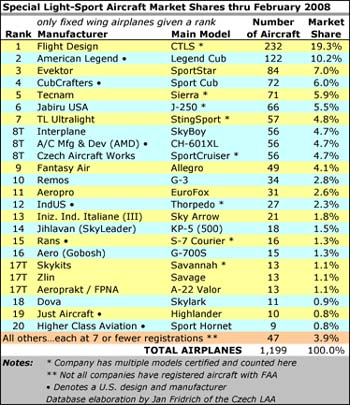

PostPosted: Thu Apr 24, 2008 11:57 am    Post subject: Re: CH601 Yuba City Photos Link Reply with quote
This was my point from an earlier posting that no one commented on. I counted about 240 registered XL's in the US. 4 structural failures equals 1.7%. That seems quite high to me. I also looked at the NTSB records for the top LSA's on the market and found zero structural failures and very few fatalities. Planes just don't break up at that rate.
Flight design sold 232 aircraft in 2007 with many more already flying. What would everyone think of them if they had 4 structural failures in the last two years? Go ahead and look at the fatality stats for the other top LSA or even homebuilts. Nowhere close to 1.7% structural failure rate or even fatality rate.
I was not part of the panic crowd earlier as I tried to explain away the other issues but standing back and looking at 4 structural failures out of 240 in the US, something isn't right here.(regardless of wheather we know why) I fully understand the risk of flying and building, but not when the deck is stacked against me from the beginning. If there are 120 of you reading this and building now, 2 of you will die from a structural failure at 1.7%. Think that's a low number now? What about the 120 people in your EAA chapter. Expect that 2 of them will have structural failures?
I know we don't want to hear this but there is a problem of some sort and I'm not sure what to do now with my 80% complete airframe and brand new engine. I don't want to invest more time and money into a flawed machine. I wouldn't fly my 172 if 1.7% of them were failing structurally.
If anyone wants a plane or jab 3300 let me know, I think I'm done....
The 06 crash in Ca did not have hinged ailerons and the one in Fl. did. So that don't help much. The main problem is that no two aircraft are build exactly the same so it would be hard to find a common problem unless it is a clear design flaw and I don't see that. If the spar had a major flaw we would be seeing a lot more of this as the number of 601's are finished. and 4 out of almost 300 is a very small percentage.
