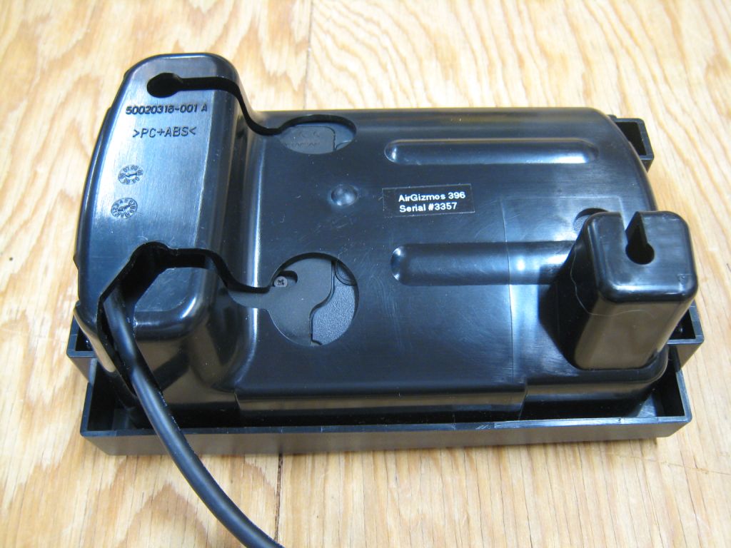

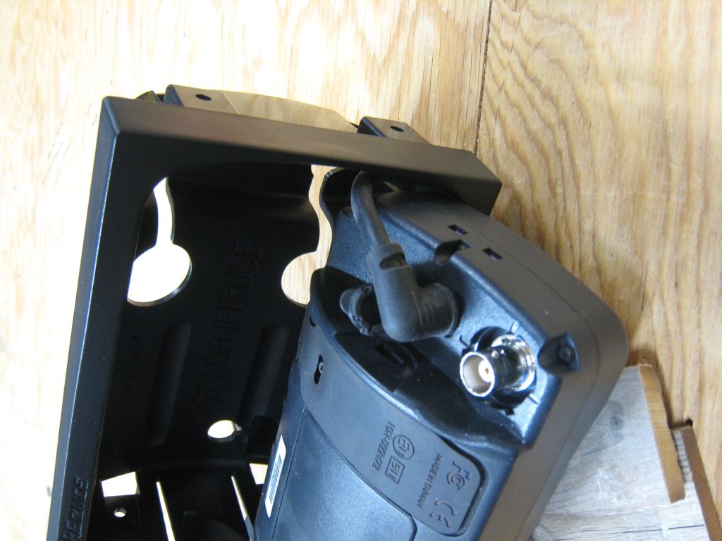

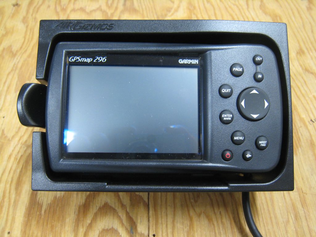

My 296 fits fine with the cable shown in the attached picture. This is the older "396" dock before Air Gizmos redesigned it to accommodate the extra cable on the 496. The p/n of the cable I use is 010-10513-00. It ends in bare wires. Info here:
https://buy.garmin.com/shop/shop.do?pID=1083
