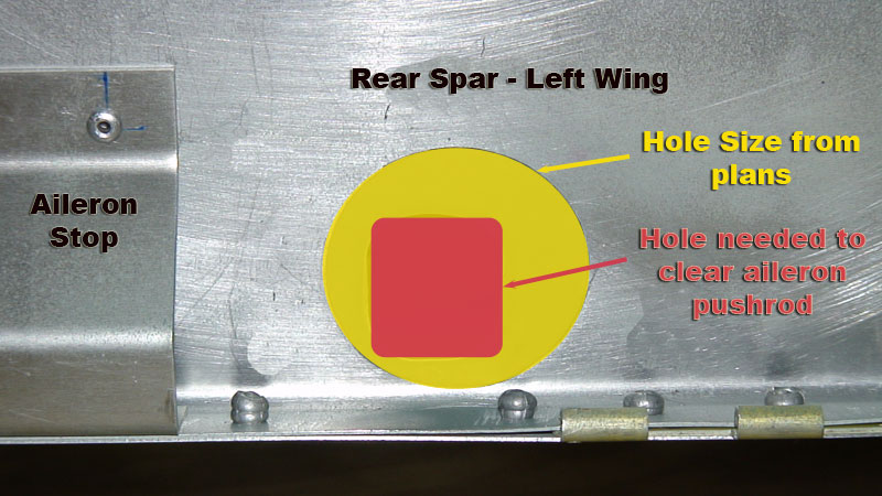

Tim Juhl
Joined: 21 Mar 2006 Posts: 488 Location: "Thumb" of Michigan
Posted: Thu Apr 10, 2008 8:55 am Post subject: Re: new member questions |
I believe that the hole as specified in the plans is larger than it need be. I would suggest going a smaller and then clecoing the aileron in place and connecting it to the bellcrank with the pushrod. Run the aileron to it's limits and you will see exactly what you need. You can always make it a little larger once you've seen the fit.
There is plenty of support around this area but why remove more metal than necessary? That said, be sure to allow enough wiggle room so there is no chance of binding in the hole. I've attached a pix of what I found would work for me... your experience may differ.
Tim
