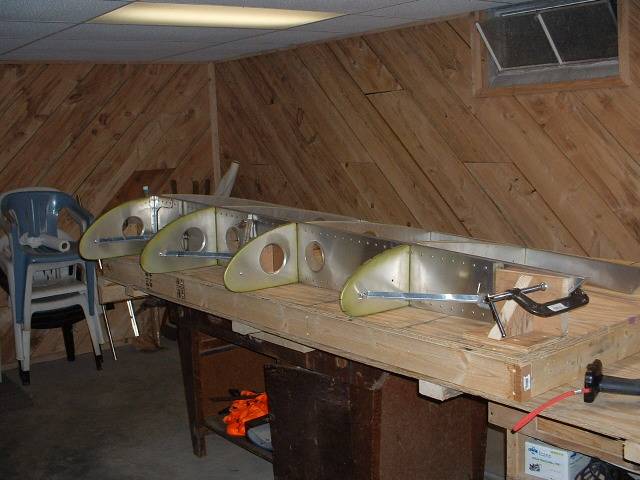

Dave-
In spite of the fact that I had problems with the spar web pre-drilled holes, this was the answer for me. Avoid movement and you avoid trouble.
If you have to trash the existing skins, you can make new ones relatively cheaply in a short time with an Olfa knife.
You can tell this is an old picture- the windows are open!!
Bill
