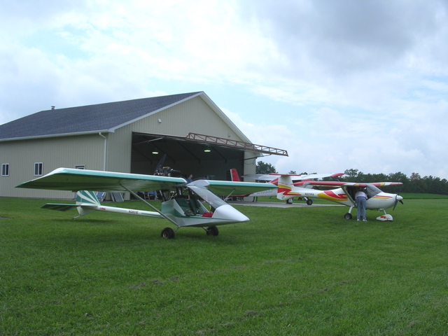

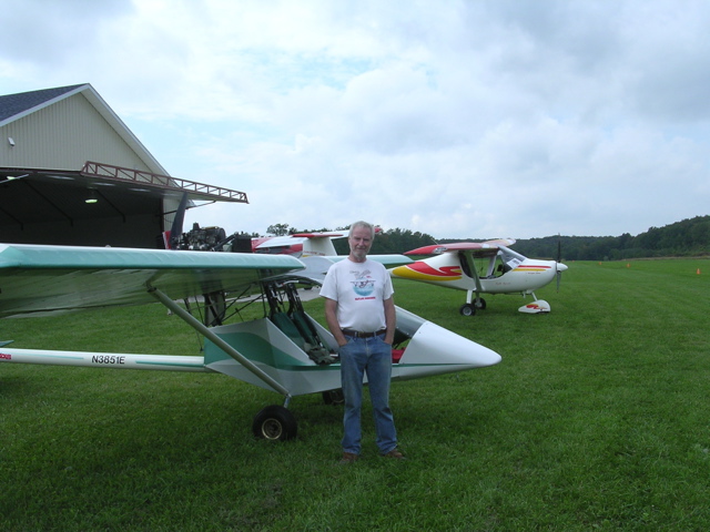

Regarding "missing" center section between wings on MkIII:
Attached are a couple photos of Bob Bean's MKIII (and my Allegro) with "missing" center section. You can't see it in the photo very well but Bob made some Lexan end plates (airflow fences) that are the shape of the airfoil plus about 2-3" all around. According to my memory, the addition of the airflow fences made a very big improvement compared to flying it without the fences. BB can chime in any time if my memory is in error.

I put the fences on after flying it with no center section. I could
tell a lot of lift was being lost.
The fences prevent spillage off the wing roots. I figure I have the
best arrangement due to
better airflow and less drag. Any airfoil that has an engine popping
up through it can't provide much lift.
I have since thought about a tip modification but won't mess with
that until I bash something.
BB

Interesting. Hard to tell from the pictures, it looks like they're only
about 2" high, is that right? Surprising that such a low fence would have
that much effect. Another plus is that you could leave a cutout in the
root so you could see into the wing for inspection, and the lexan would
cover it. Do they get in the way of folding the wings?
