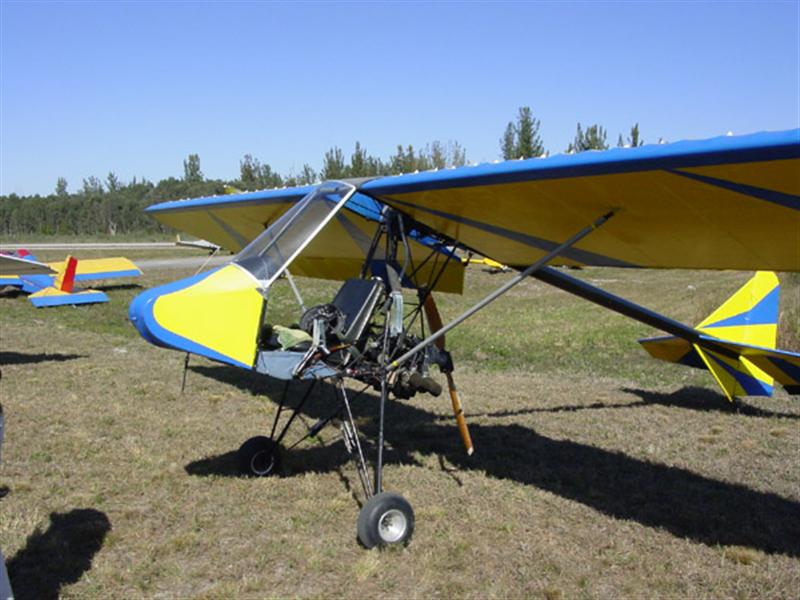

What did this guy do wrong on landing his UltraStar to cause gear collapse?
Review this short video clip:
http://www.youtube.com/v/0hqEBYcFp4k
I think he might have been going a little fast and high and chopped to much power and came down hard.
Seems like the "Fly it On" technique is the way to go instead of trying to force it down without sufficient speed or power.

I can't figure this one out!! I have watched that video at least 10 times, one right after another, and I still can't figure out why he lost a gear leg.
He appeared to have PLENTY of airspeed. Although it appeared he was a little high in his flare, I still think he could have just bounced a little.
In my opinion, either he hit in a little pothole, or his landing gear leg assembly was defective. I do know that some of the early UltraStar kits were "weld it yourself". I know a guy that got one of those "weld your own's". It was disgustingly poorly built. Even the wings were horribly put together. This particular UltraStar undoubedly would have crashed IF it was ever finished. Thank God, this person never finished it, and it was abandoned to rot.
My friend, Frank Reed, in Hayden, Idaho, a true and genuine craftsman, rebuild this mess, and staightened the whole plane out!! My guess is, the video UltraStar might be one of those planes that should have NEVER been flown.
I think people like John H., and others that have UltraStar flight time, may have a better analysis of what went wrong.
Mike Welch
Ray:
I agree with you to a point.
Without sufficient flying speed, one does not have to try to force it down.
It does that all by its self. Seemd the pilot stalled the aircraft high.

But seriously, he slowed it up too much, too high, and dropped it
in. Common ultralight newby error.

Don't pay too much attention to this post, as I've never even piloted
a Kolb -- but it sure looks to me as though the TAIL stalled, and
caused a sudden nose pitch-down. Which ANY aircraft can and will do
when it's slowed down too much.
Very bad if it's too near the ground.
Feel the aircraft out AT ALTITUDE. Fly safe!

| jb92563 wrote: | What did this guy do wrong on landing his UltraStar to cause gear collapse?
Too many previous hard landings and/or a bungee gave way?????

Should have been able to take that little drop. A part must have
been ready to fail.
I've dropped my (600 lb empty) MkIII lots of times at least that hard
with no damage.
-tis a stout bird.

I checked the original post on YouTube. The following are quotes from the person that posted the video. Best first-hand information that I can find to make a guess at what really happened and even this might not be the true facts.
From what I surmise is a faulty repair was made and lack of good training and mentoring. The last quote implies that the gear failed on taxi tests. He then continued and got airborne unexpectedly. Hate the term Kolb drop. We fly a low inertia, draggy airplane and have to be aware of that, then it gets easy. This is what allows a Kolb to land and takeoff places that very few other planes can even attempt. Why I got one! Saved my butt in an hayfield in Texas!
| Quote: | | nope landing gear failed |
| Quote: | | 1st time he flew the plane and he did not tell anyone. my uncle gave him heck(the big guy running) he had never flown anything in his life before(which was not too smart). |
| Quote: | Thanks on all the comments every on(except from twitch15 which his name explains it all)
it was my stepdad flying and he is perfectly alright, he got the ultrastar back together bue he did not build it strong enough, the first time he was out the landing gear slowly folded while doing a mid-speed taxi

That's what I thought, too, as did Bob B. Both of the ingredients of a guaranteed failure; lousy construction of an aircraft, and an untrained goofball. He is lucky he lived to tell about it. I hope he got proper instruction, if he continued to fly.
This makes me wonder about the UltraStar frame you have, Ray. As I said, I know of an UltraStar frame that was assembled with rotten quality control. I have NO doubt that this plane would likely have crashed, if it were ever finished and flown.
Ray, how certain are you that the frame you have is "good, and of aircraft quality"? Have you, or a professional welder, done a thorough inspection to make sure the frame is as solid as you think it is?
I recently heard a comment from an FAA Crash Inspector say, "a catastophic crash is never a spontaneous action, but rather, it is a culmenation of a series of events and decisions that lead up to the crash." (or words to that effect)
Having crashed just like this moron (yes, I was stupid, stupid, stupid!!!, and even worse, I have it on film!!), I have learned not to assume as much as I used to. "Now", I rely on training, and better quality control. It was an expensive lesson, but I believe I learned from it! Hopefully, I am not near as stupid!!!! In my case, I got hurt more than the ultralight!
It is my belief and understanding that Kolb aircraft are quite possibly the best flying light planes there are. They do, however, require standard aircraft quality construction, maintenance, and equally important, a "thinking" person at the controls. Those Kolb pilots with hundreds (or higher) of hours flying them probably agree.

UltraStars don't have bungees, just a rigid gear, not even the spring steel
gear of the later Kolbs... the only shock absorption is the tires, so you
have to land it gently. I watched the previous owner of my plane break a
gear in a landing that looked no harder than the one on Youtube (to my
friend's credit, it was a dead stick landing during his first solo in the
plane... he got it onto the runway but had no speed left).

While not stock set-ups, I personally know of 3 different Ultrastars that had bungee suspension systems on their mains.
The attached images are of a very highly modified one (used to belong to Richard Swiderski of this group) with a bungee system.
Sorry I don't have images of the other two.

Ah yes, the "stork" UltraStar. I've heard of US's being modified with
FireStar gear, too. The problem is, you have to add the height to insure
adequate prop clearance when the gear compresses. The previous owner of my
plane just installed much larger, soft tires... but then it wouldn't fit in
the trailer so I had to go smaller again... and land carefully.
