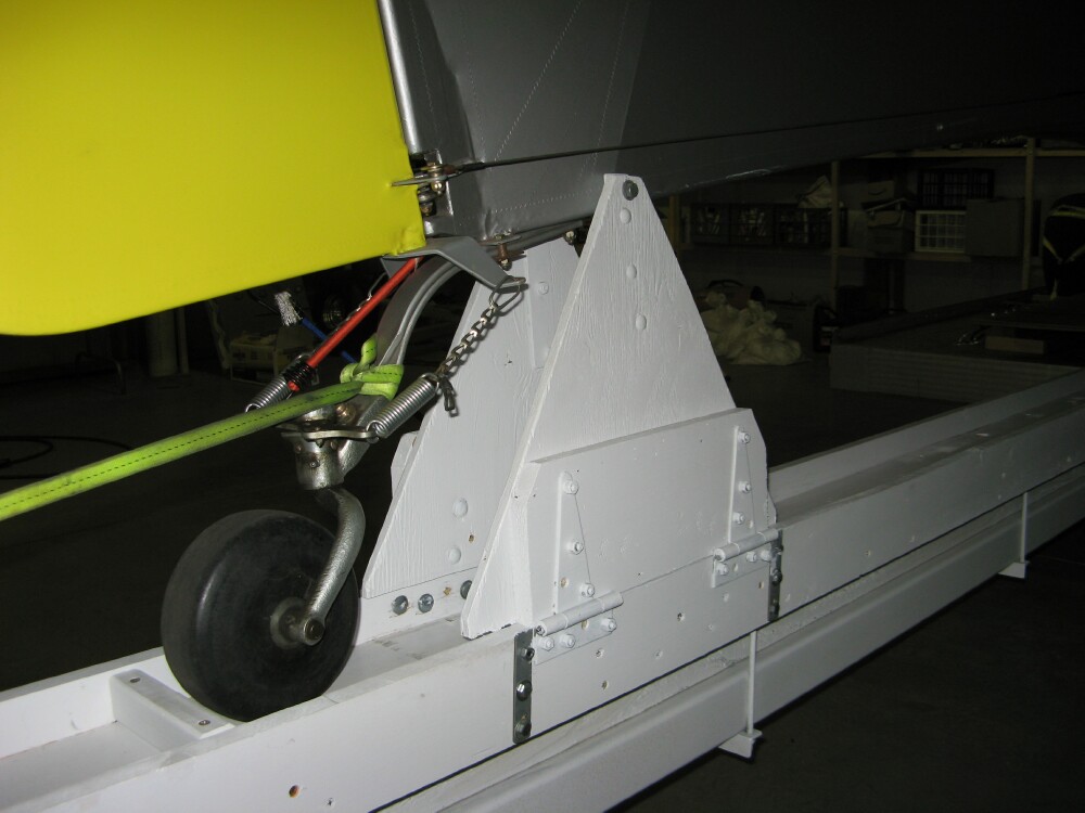

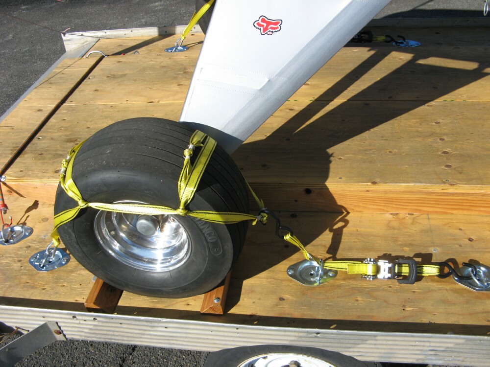

Float Flyr asked
| Quote: | | I use my ramps to trap my main gear. Do you support your tail when towing or leave all the weight on the tailspring? |
Noel, I'll answer in this thread as it is about trailering. I tried to design ramps like yours but wanted them long to have a shallow angle to pull the plane up. I keep my Kitfox at home and trailer for each flight The ramps are too long to fold back to trap the tires. They would hit the wing support braces.
I made some wheel tie downs out of two 16 foot ratchet straps. The tail is supported by the triangular shaped plywood that is hinged to fold down out of the way of the rudder horn when loading and unloading. I can unload and be ready to preflight in 15 minutes now.
To load, I set the tail on the trailer to fold the wings, then pull the plane up the ramps with a small boat trailer winch. I weighed the tail with the wings folded. It weighs 175 pounds.
Pictures attached.

Tom:
It's been a while now since I had my plane on wheels but I used to put the
plane in the towing position and tied down, with the tail up on a support
before folding my wings. Doing it that way I could easily carry the plane
all the way back to the point where the mains touched my ramps. From that
point, like yourself I used a light boat winch.
Taking the plane off the trailer was the reverse of loading. I would spread
the wings before untying and I would also use the winch to lower the mains
to the ground on the ramps...
Thanks for the reply
Noel
