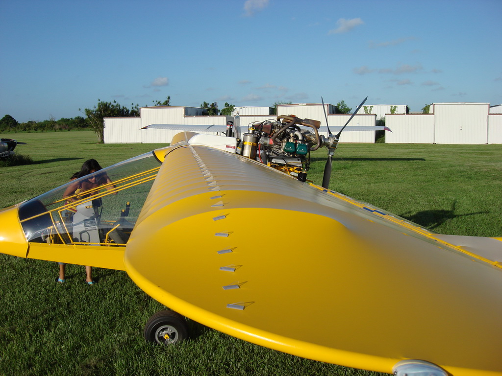

First, if you have seen the videos on YouTube that are being discussed, I am the pilot in the videos. (Michael Adams, age 36) My father built a Firestar 1 back around 1990 which is where I received my introduction to the Kolb aircraft. He has flown many airplanes in his 40 years of flying and to this day he will tell you hands down, the Firestar is the best airplane he has ever flown. After receiving my private pilot certificate, I got a chance to fly his airplane and it was a joy. It wasn't long after that I got a Firestar 2 for myself. In fact, the private airport where we fly has a small hangar (barn) with about 12 to 14 airplanes (approx). There have been 8 Firestars in the hangar. It wouldn't be a stretch to say that most of the Firestars are there because those people saw the performance of my fathers plane and just had to get a Firestar themselves.
Now, I have around 500 hours in my firestar. This does not make me an expert but I feel I have enough experience with the airplane to know its flying characteristics. The Kolb is a wonderful airplane but as with all airplanes, it has characteristics that need to be learned. I would also say it's very possible that one Kolb may not perform exactly like another Kolb of the same model due to building methods, pilot weight, etc. With all that said, I'll tell you how my airplane flies.
(Please read everything I'm about to say before jumping on my case)
I believe the term "Kolb Drop" is really a tendency of not flying the airplane to it's true flight characteristics. When the airspeed get's slow enough or the angle of attack reaches that critical spot, a wing will stop flying. Now I'll admit, I've had the airplane drop on me when I wasn't expecting it. Was that the airplanes fault? Nope. I just had to learn the characteristics of the airplane. I did know that it wasn't my wing that was stalling but rather my stabilizer/elevator. Slow airspeed, cord line change, angle of attack during landing, ground effect, all play some small role. The solution at the time was to land the airplane like it wanted to be landed which meant two point landings. To me it actually felt like I had the nose pointed up high in the air but videos would show my tail was still up in the air. I really thought I had been making three points. Two point landings were very comfortable but three points could still be achieved if I really worked it and kept about 3,000 rpm's on landing. If I just landed two pointers, there would never be a problem. (Please remember, this was my Firestar... others may have no problems with three points)
Now for the interesting stuff. I had been reading about VG's and figured, it probably would do no harm to at least test them. Wouldn't it be great if you could take a wonderful flying airplane and somehow make it even better? So I bought some VG's and installed them on the wing and stabilizer. Before hand I had done some cruise speed test and also side by side slow flight comparisons against my fathers Firestar 1. He was always able to fly just a little slower than me but only by about 2 mph. I'll come back to that comparison in a bit. With the VG's on the airplane, I took off and really didn't notice anything. I then applied full power and pulled the stick back. I wouldn't think a Firestar would climb any steeper than it had before. After all, how can one climb quicker than a home sick angel? Well, when you put on VG's, that angel now has a fire under its butt and the only place to find a bucket of water is in heaven. I then ran some cruise tests with a GPS. My cruise speeds were unaffected. The next test was slow flight against my fathers Firestar 1. I was now able to fly a couple a mph slower than him, but only a few. So far, the climb rate was the only big difference. I also did some stalls. Power off felt about the same but the recovery was quicker. The power on stall was impressive. The airplane didn't want to stall. It just wanted to mush a little and then keep flying. Boy, the nose was high. The overall stall speed dropped by about 4 mph. I was hoping for more. Now for the biggest difference. Landings!!! I kept shooting landings and with each one kept pulling more and more back stick. Eventually the tail wheel was rolling on the ground way before the mains touched. This could also be done at a throttle setting very close to idle. Before, the elevator would stall once you pulled the stick back past neutral (That was one of the things I learned to avoid when landing before - it's also amazing how little elevator deflection is needed to flare or even climb - take some video and you'll be surprised when you can't see any movement on the elevator - I digress)
The airplane now has some new flying characteristic that I had to learn. The main thing is my landing speeds (once in ground effect) are much slower than I could have landed before. The elevator is effective all the way back. Why wouldn't anyone want to slow down their ground speed during landing if they could? The Kolb is one of the best planes out there without VG"s but WOW! With VG's... the difference cannot be put into words.
I wanted my father to see what he thought of the VG's so he took my airplane for a flight. He has over 800 hours in his Firestar and has flown my airplane for many hours. When he landed, he just couldn't stop talking about the positive effect the VG's had on the airplane. He was very impressed. So impressed that he decided to put some on his Firestar. He only placed them on the horizontal stabilizer and he really didn't use that many. (Here's is a good tip - he purchased r/c airplane wing skids that look just like VG's that can be made or bought. They are very cheep but are a little thicker than VG's that can be purchased) He was amazed at the difference it made to his landing speeds and flare. It's really one of those things that has to be experienced. We then did the side by side slow flight comparison and he was now flying at my speed. I believe if he added them to the wings he might be able to fly a tiny bit slower, but probably not enough to make a huge difference. The big difference is the stabilizer. If you can keep it flying (applying downward force) at a slower airspeed, you can keep the nose the airplane up and slow down.
So, here is my brief summary.
The "Kolb Drop" is a result of the pilot not flying the airplane like it should be in it's current configuration. I did it until I learned better.
VG's added to the stabilizer made a tremendous difference.
The Kolb Firestar is a wonderful airplane just as it is. It's hard to believe but it can be better with VG's. VG's would probably improve any airplane when properly installed.
For those of you that don't have a Firestar (or other Kolb aircraft), get one.
For those of you that already have one of the wonderful airplanes from the Kolb company, place some VG's on your stabilizer. (and wing if you really want)
About the videos. Most of the flying in the Firestar 1 and 2 video is without VG's. All of the other videos show the airplane with VG's.
Long live KOLB!!!

What he said -------ditto:
It's amazing how far I can stick the nose up without
the plane stalling.
I'm not trying to beat this to death, but there are very few things that
you can do to your plane that (1) doesn't do anything at all for the performance - after
spending lots of time and money or (2) actually degrades the performance of what you
were trying to do anyway. I've spent lots of $ for nothing several times.
I was just surprised at what these little things would actually do for the
amount of time and money invested. And like Jeremy says it's not just that you can fly slower,
it's "how well" you can fly slower. I fly my plane slow - a lot.
On a cross country trip, maybe you won't need them at all, but they
sure are fun to play with around the patch. I'm sure the buzzards & the geese
are glad I have them too.

Michael,
Thanks for the great report. Several years ago when I had a FS 1, I made and installed VGs on the wing and got a few mph drop in stall speed but the stall was sudden w/ VGs when it was more gentle w/o wing VGs. I never considered adding them to the underside of the HS.
I now have a different and good bit heavier FS 1 that is under repair and won't be flying again until summer. It flies somewhat differently from the first lighter one. My current FS 1 seems to be limited by pitch control when landing, much like you described. Once I get all the repairs done and it is flying again, as before, my first addition will be VGs on the underside of the HS.
Thanks again for your excellent report.

| Quote: | I would also say it's very possible that one Kolb may not perform exactly like another Kolb of the same model due to building methods, pilot weight, etc....
Eventually the tail wheel was rolling on the ground way before the mains touched....
The power on stall was impressive. The airplane didn't want to stall. It just wanted to mush a little and then keep flying. |
Michael,
You did a great job of describing the characteristics of my KXP. I can drag the tail wheel on landing, hold the stick all the way back and not lose elevator control, and do full power, full back stick mushes with only a stall buffet. I do all of these with no VGs.
I installed VGs a couple of years ago, but removed them because of the sharpness of power-off stalls. I can drag the tail on landing without them. With the VGs the tail would touch while the mains were still a good foot and a half in the air. The mains would then plop down a little harder then I wanted. If I ever get around to adding longer gear legs, I will try them again.
Thanks for the great videos and information.

where does one place the vg's on the horiz stab?
| Back to top |
Possums
Joined: 03 Nov 2007 Posts: 247
Posted: Tue Feb 26, 2008 6:08 pm Post subject: Firestar Videos and VG's |
At 08:38 PM 2/26/2008, you wrote:
| Quote: | --> Kolb-List message posted by: <apilot(at)surewest.net>
where does one place the vg's on the horiz stab? | http://www.landshorter.com/page4.html
If you decide to use them on the underside of your horizontal stabilizer to improve
your flare then you will place them about 1" apart and just in front of the elevator.
_________________ Possum |

I am guessing the VG's were just a smidgen too far aft. They were grabbing energized air but barely. I would just for grins place them about .25 inch further forward to see what happens.

Mike,
It would seem obvious that from all of the first hand reports of List
members who have made their own VG's that placement on a thick wing is not
that critical. Some were placed on the rib, and others between the ribs.
Some were placed in a straight line and others were placed in split lines.
None of these people reported that they were going to take them off. This
leads one to the conclusion that home made VG's must be effective.
The advantage of the trapezoidal VG design is that they can be held in place
temporarily by black electricians tape. This makes it very easy to move the
VG line forward and backward to find the sweet spot. Performance value is
easily checked by teasing your aircraft off the ground into ground effect
while watching the ASI to see at what speed the wheels break the ground.
This can be followed by performing power off stalls.
I am sure that Landshorter VG's are very effective, but you can save about
$80 -> $90 by making your own.
Like most things, whether to install VG's or not is, a personal decision.
In my case I tried them and I will never take them off.
Jack B. Hart FF004

Posted: Wed Feb 27, 2008 8:12 am Post subject: Re: Firestar Videos and VG's |
Jack,
There is plenty of evidence to show that home made VG's work, I'm just not sure you are getting the full benefit as you would with landshorter VG's. The only way to know that would be to flight test the difference between home made designs and the landshorter design, which would be a huge amount of work. Joel who owns www.landshorter.com says he has tested the size, and shape of different VG's in a wind tunnel, and optimized his for small experimental sized aircraft. Landshorter VG's can be attached with double sided automobile trim tape, and moved at will, or taken off if you don't like them, Possums came up with this idea and my VG's have been on my plane with double sided tape almost a year now, I have not lost any. Position of VG's is critical to get the desired results, the landshorter VG's specify exact positions, and even on VG kits for certified aircraft, they come with a large template and instructions for exact positioning... So its very clearly important. Attached is a picture of my VG's.
I have spoken to Joel at landshorter several times on the phone, and he is a great guy that is very technically competent. Joel is an aerodynamics engineer and sells the VG's on the side. There is not much profit in selling 100 lexan VG's for 100 bucks, its not a big market. Given the time Joel spends on support and answering questions, his motivation is clearly to help aviation the community more than to just make a couple bucks.
Mike
| Description: |
| www.lanshorter.com VG's on Kolb |
| Filesize: |
257.31 KB |
| Viewed: |
691 Time(s) |
_________________ "NO FEAR" - If you have no fear you did not go as fast as you could have !!!
Kolb MK-III Xtra, 912-S |
