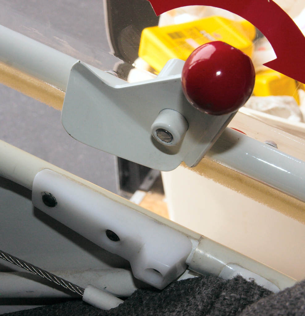

Attached please find the promised door latch pictures. The
lug in photo 2 was bought with Murle's kit. I couldn't make his kit
work because the latch wasn't long enough to reach my sill. (It could
have been made to work with some tube bending and counter-sunk
screws.) I made this latch because it self aligns and "snaps" when
closed. I used wave springs to provide enough friction to keep the
latch where you left it last.

Guy,,,That is some nice work..Steve Shinabery N554KF KF2

Quick questions, does your window fit flush with the opening or does it
overlap the opening. I believe that if my window overlapped I wouldn't have
the problem of the window bowing out in flight. Jeff Classic IV CMH

At 06:47 PM 2/18/2008, you wrote:
| Quote: | Quick questions, does your window fit flush with the opening or does
it overlap the opening. I believe that if my window overlapped I
wouldn't have the problem of the window bowing out in flight. Jeff
Classic IV CMH
My window is recessed along the forward edge, flush along
the top edge, and overlapping along the bottom and aft edges. My
window doesn't bow because it's a bubble door, and therefore
incredibly stiff, with or without the frame.
Guy Buchanan
San Diego, CA

I do have the bubble doors. I think I trimmed them too close. Jeff

At 10:58 AM 3/3/2008, you wrote:
| Quote: | Gary,
If you ever make these for purchase I will take a set. Jeff Classic IV CMH
Oh my. I can't even imagine what they would cost. It took
forever! I could tool it and make 1000 to get the price down, but I
don't think the market's that big. Oh well.
