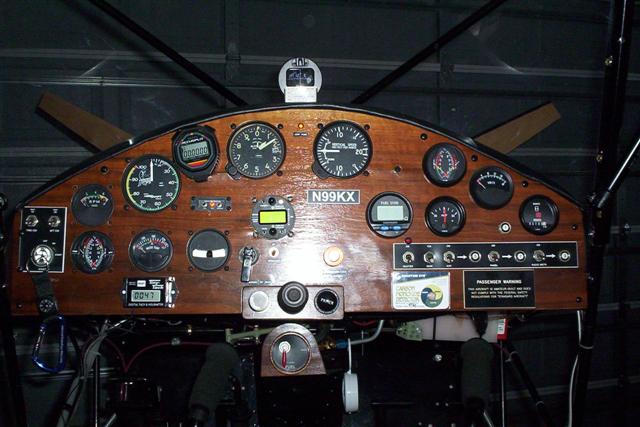

I made the same decision after my ill-advised IMC adventure on the way home from OSH last year. Did not know that the 2 1/4" doesn't feature a ball, but it makes sense as small as it would have to be. That complicates things for me, however, having no 3 1/8" openings to spare and little room to add a new hole. I was hoping to pick one up at Sun-n-fun in April but don't really want to have to reconstruct my panel to accommodate it.

Yeah, I have one of those Travis. I was hoping to replace it with the ADI. So either way, I need another hole in the panel. It's tight, as you can see.

Guy Buchanan
Joined: 16 Jul 2006 Posts: 1204 Location: Ramona, CA
Posted: Thu Feb 07, 2008 5:00 pm Post subject: Need advice on TruTrak ADI |
At 01:40 PM 2/7/2008, you wrote:
| Quote: | Yeah, I have one of those Travis. I was hoping to replace it with
Marco,
Check out ACS. They have balls that mount to the face of the
panel. You could put the ADI where the 2" ball is now, and put a face
mount ball below it. Plenty of room.
Guy Buchanan
San Diego, CA
_________________ Guy Buchanan
Deceased K-IV 1200
A glider pilot too. |
| Back to top |
Catz631(at)aol.com Guest
Posted: Fri Feb 08, 2008 5:58 am Post subject: Need advice on TruTrak ADI |
Marco,
I removed my 2" ball and installed the UMA airspeed in that hole then installed the TruTrac ADI(with GPS &antenna) where the old 3 1/4 " airspeed was. It works great and everything is within a 6" space.A Garmin 396 is next to the ADI Dick Maddux
