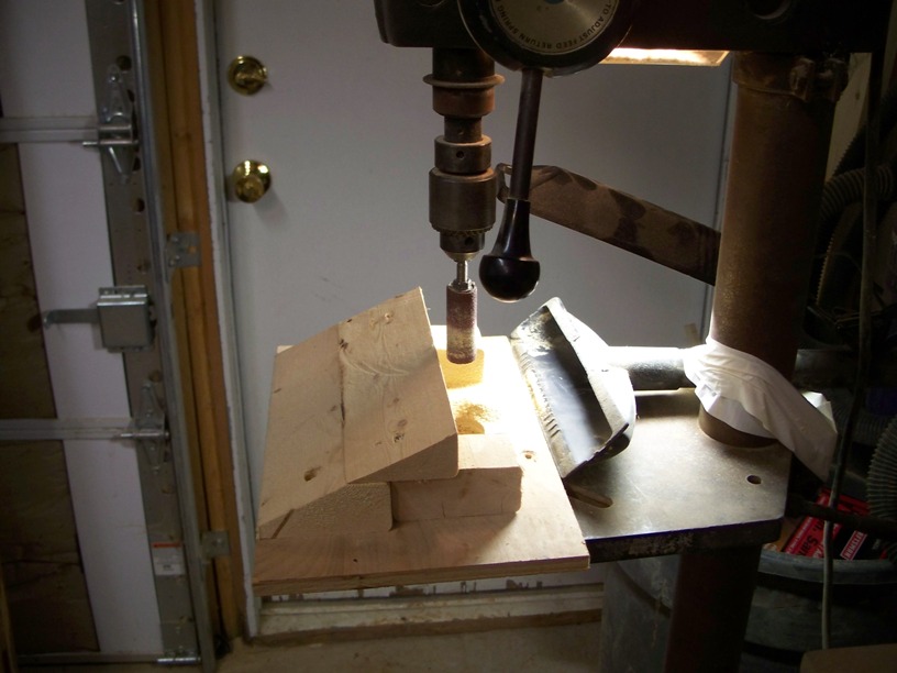

| Quote: | | Quote: | When I first decided to switch to scratch building, I thought it would be easy
to find a builder willing to pass on his old forming block when finished with
them. I was surprised when my post last year got no responses offering to sell
old forming blocks. Now I see why. Building these things is a kind of a 'right
of passage". No one should be able to say that they scratch built a plane if
they didn't have to make these things. Cutting metal and popping rivets is
easy. I find making the forming blocks much more tedious. Anyway, I am almost
done with wing forming blocks. I just have to make the relief cuts and I am
done. Lets see, there are 15 relief cuts on each block, times 18 blocks.
That's 270 relief cuts! I made a jig for my drill press and it works fine, but
its not near as quick as the oscillating spindle sander that Mark uses in his
"Scratch Built Basics" video. Ugh! I long for the day that I can pop another
rivet!
John Hines
www.johnsplane.com |

I've made my relief cuts with the router and a 45 degree trimming bit. It is a painless and quick operation.
However, If you make them with your router and you use them as mold to make your crimps in the manner shown in Mark's scratch building DVD, they might come out too wide. I use the ZAC crimping tool for this and the results are great.

The reliefs were made using a 3/4" 24 grit barrel sander in a die grinder, took about an two hours to mark and grind em in.
YMMV

My form block reliefs were all done by hand. I was going to use the tapered router bit method, but I would've had to wait three or four days till I could get to a shop that had them from where I live, so I decided to start there and then.
Roughed out with a rasp, then finished with a file using an aluminum angle as a jig. See here:
http://eastcoastit.net.au/zenith/?p=58
If form blocks are a rite of passage, then I've done my time.

Don't bother with the relief cuts. You will have to finish the bend with
your hands some anyway regardless. Just get to making some parts.

| Ron Lendon wrote: | The reliefs were made using a 3/4" 24 grit barrel sander in a die grinder, took about an two hours to mark and grind em in.
YMMV |
I take it you mean two hours to do all of them on all the forms, right?
I did the same thing, I used a little barrel sander in my dremel tool. Took like 5 minutes to do one of the wing rib forms. You don't even need a template, just hold it steady.

Guys,
Here is a picture of my jig to make the relief cuts.
John Hines
www.johnsplane.com
