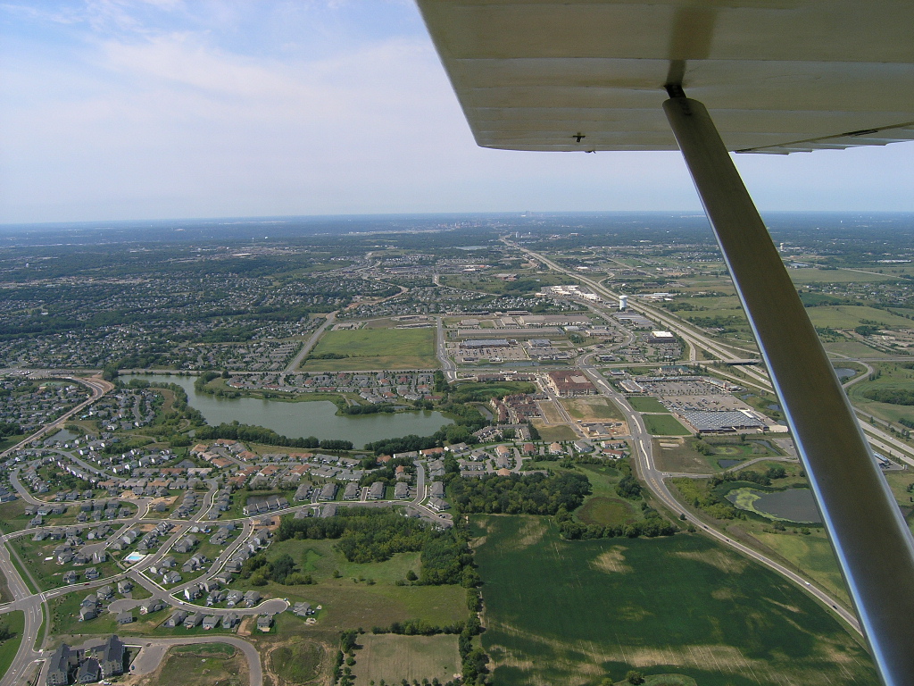

I replaced mine on my Original Firestar (that often gets mistaken for a Firefly). Mine are the kind with the tube inside and are all aluminum. I gained about 5 mph in cruise with them.

I considered using Aluminum struts on my MK III Xtra. Right now, it has steel covered by streamlined plastic. I liked the idea of just having a " Real " aluminum strut. After talking to Kolb and some other people, there was some question as to weather the aluminum struts would meet the compression requirements ( Not fold in case of negative G's ). Being that I could not determine that, I stuck with the steel ones Kolb provides. The plastic covering seems strong enough, and has not cracked or even started to work loose as I had feared.
It may work fine, but do your homework and be careful when making structural changes to your Kolb. There can be many unintended consequences one never thinks about when doing something like that.
