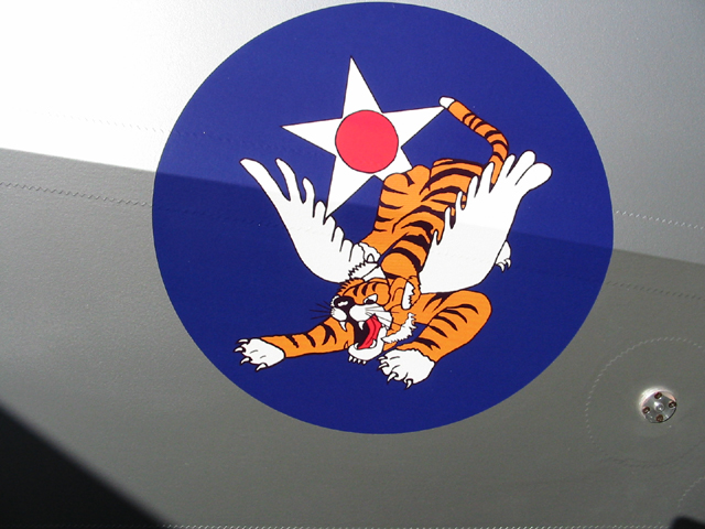

I have some vinyl graphics on polytone . Put them on when the polytone had been on for one year. They have been on for seven years now. Six years as a hangar queen and nine months flying now. They still look like new.
| Quote: | | Anyone have good experiences with any particular online vinyl lettering company? |
My wife made the designs on her computer and put them on a CD. I took the disk to a sign shop and they printed them up. I had them print the N numbers too.
