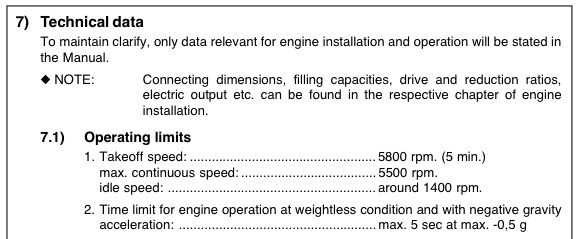

Most of the guys responding to you so far are flying airplanes with the 912ULS (100 hp) but your question was about the 912UL (80 hp) which is what we have in our Allegro 2000. The 100 hp engine may indeed need 1800 rpm idle but the 912UL does not. Ours is set for 1500-1600 rpm idle speed when fully warmed up. Setting it cold won't do you much good because it will change when warm.
The Allegro is a floater too and anything above 1600 rpm idle (912UL) will make final approach difficult, just as you have experienced in your Kitfox. Roger and I have had this discussion before.... search the archives.
One thing no one has mentioned yet is this. When you buy someone else's experimental aircraft, you may be in for some unexpected surprises. Are you sure you have the Rotax/Bing supplied springs on the carburetors? If a previous owner lost them and bought stronger hardware store springs, instead of the more costly Rotax springs, this could explain the difficulty your were having with holding throttle position.
Thom Riddle

To get a 912 series engine to idle smoothly in the 1500-1600 rpm range requires careful mechanical and pneumatic (vacuum) synchronization of the carbs. The mechanical adjustments must be done first and can be done without running the engine. Once that is done, the engine must be fully warmed up to do a proper vacuum synchronization job. The best way to ensure it is warm enough is to fly it and then do the vacuum balance. This requires dual vacuum gauges. We bought ours from Lockwood (I think). The proper procedure for doing both of these is in the Rotax Line Maintenance manual.
If after reading the manual you have any questions, let me know. I know of several Rotax 912 owners who never synch their carburetors but it does make a difference if you want a smooth idle at 1600 rpm or less (warm).

PostPosted: Sun Dec 30, 2007 5:07 am    Post subject: Re: Replacing throttle return springs Reply with quote
I keep hearing many folks on this list saying that 1800 rpm is minimum recommended idle speed for the 9 series Rotax engines. Can someone show me in the Rotax Documentation (not Lockwood) where it says that? The reason I ask is that the attached file is a snapshot from my 912S Installation Manual.
As you can plainly see it says IDLE SPEED AROUND 1400 RPM. I'm going to piss off some folks here with my next statement. If you can't get yours to idle smoothly at less than 1800 rpm, perhaps you ought to have a professional mechanic do it for you, because something may be amiss in your procedure or your engine.
As the owner operator of your airplane, you are entitled to set your idle speed at anything you want. If you are happy with 1800, then so be it, but don't tell me THE MINIMUM RECOMMENDED IDLE SPEED is different from what the Rotax Installation Manual says unless you can document that in another Rotax Document.

Thom Riddle
Posts: 1597
PostPosted: Sun Dec 30, 2007 5:29 am    Post subject: Re: Replacing throttle return springs Reply with quote
Paul,
I'm glad to hear that you are able to get your engine to idle at less than 1800 rpm. I was beginning to think that I was some sort of real world evil wizard like my alter ego, Lord Voldermort of Harry Potter fame. do not archive
