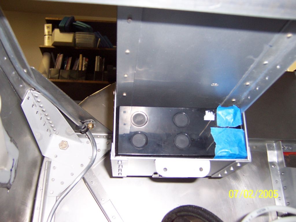

Vern, this is in my 7 but the same concept probably works in the 10. Battery is suspended directly under the AHRS. The bus right beside it is the Aux Bat which feeds separate switches for the EFIS which allows it to be powered on before/while starting or in an emergency but disconnected from the main bus. The Aux Bat also charges from the main bus during normal operations through a D25 diode. As I remember it, the battery is a Panasonic P212 (7ah) recommended on the AE list.
Hope this helps.

Thanks for the information and pictures on the Battery/trays. Bob, I really
like the looks of that accessories tray that you built. If you get some
pictures of it please let me know. This would be a good time to work
something like that into my build. As for the battery tray dimensions, I
think I'll probably go with PC680s. The length is 7.27" and the width is
3.11". Do I need to buy the batteries and build the box to exact dimensions
of the 2 batteries or is it acceptable to just build the tray maybe 1/4"
larger on each side so that I know the batteries will fit later on when I
get them.
Thanks again for all the input,
Bill Britton

Bill Schlatterer
Joined: 09 Jan 2006 Posts: 195
Posted: Fri Nov 30, 2007 6:19 pm Post subject: Dual battery |
Forgot this one. It shows the rear and front hold down brackets. On the front, it is just a little plate that is bolted in to hold it in place. Flush rivet on the inside.
Bill S
