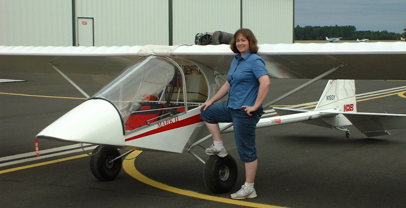

I've attached one picture. I need some nose art. See my big tundra tires? What psi would you recommend? The max psi on the tire says 20. The DAR said some guys only put like 3psi. I'm not on a grass field.

| Quote: | I've attached one picture. I need some nose art. See my big tundra
Cristal,
I have 800 size tires on my Firestar. I first had 6 lbs air in them and
ended up spinning the tube in one tearing off the stem. I am now running 10
to 12 lbs and they do well and are not too bouncy. If you don't do tubes,
perhaps you can use less air, but I haven't noticed any ill effects on my
landings from the amount of inflation that I now have.

I never use a gauge (on an airplane) inflate until it feels
unyielding to the heel of your hand
when pushed hard. Works ok on these cheap flimsy tires, maybe not so
good on those
heavy multi-ply (expensive and unnecessary ) real airplane tires.

In the picture of Crystal's Plane....
Look at the "trim tab"....is that "size" really needed ?
Seems too big , almost like it could cause "Flutter"
it's almost touching the ground , I'll bet it has.

My trim tab does drag ground if I don't keep my stick pulled back. I keep a bungee cord on it when I'm not in it.
I don't know if it's my trim tab that is too big. When I look at the picture of ropermike's Mark II, his trim tab looks to be about the same size.
However it looks like his tailwheel keeps the back of the plane up higher than mine. Kmet suggested (thanks Jim) I turn the tailwheel landing gear rod around back there to make it higher, but I'm not sure exactly what part he's talking about (the whole rod or just the attachment at the end). Let me get a close up picture of my tailwheel assembly and post it here. I'll try to get it this afternoon. I'm having to replace the nut back there with a castellated nut (per the DAR) so I have it apart right now anyways.
