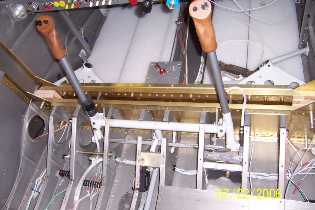

Bill Schlatterer
Joined: 09 Jan 2006 Posts: 195
Posted: Tue Nov 20, 2007 9:22 pm Post subject: Location of battery bus |
Bevan, this is what I did on my 7a for block locations. Small Tab forest on FW side to large forest on cabin side. Fuse blocks on the inside are on a swing down tray. Ran the battery lead to the always hot bus to a fuse slot which really protects the wrong end of the wire but it seemed better than nothing (maybe a fusible link on the battery end would be better). Wire is about 14" from Battery to bus as I remember it but not likely to have a problem.
Bill S

fvalarm(at)rapidnet.net Guest
Posted: Tue Nov 20, 2007 10:18 pm Post subject: Location of battery bus |
Thanks Bill
Looks very good. Nice fuse block mount. Can you access it without taking a control stick out and crawling underneath? Maybe just leaning over sideways from the pilot seat?
I see a SD8 ? alternator. Can I assume you've wired up per Z13/8? Just a guess, correct me if I'm wrong. Based on Bob's comments, I'm thinking that Z13/8 will be ideal for me. Not sure what size Odyssey batt I need. Have not completed a load analysis yet. If you are flying yet, I would like to know what schematic Z drawing you're using and how you like it.

Bill Schlatterer
Posted: Wed Nov 21, 2007 8:15 pm Post subject: Location of battery bus |
Bevan, I am using Z13/8 with the HD Endurance bus plus an Aux Bat and bus for the EFIS. I tried to shoot a picture at about the same angle as your picture with the tray down. I personally think it's very easy to get to, but probably not in flight. My copilot stick is removable, pic attached. Also Aux Bat and bus under AHRS. Note battery (P212 7ah) is attached below AHRS.
Hope this helps, locations work nice for me.
