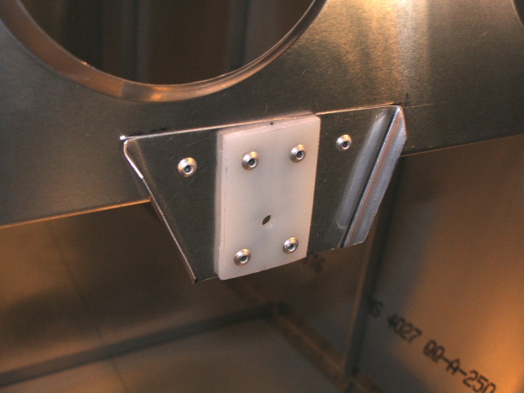

I also installed a doubler for the elevator fairlead that attaches to bulkhead 6B12-3 (see photo) because others have reported that this one is prone to break off.
