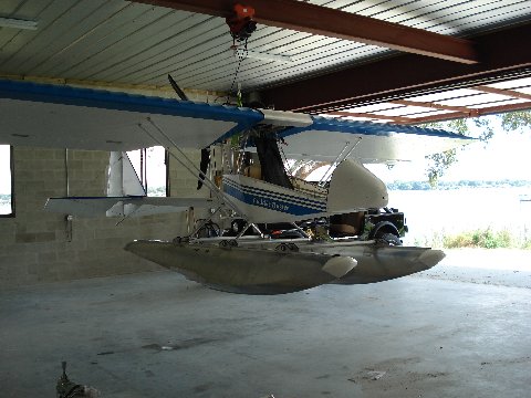

Look Ma, No Hands
Steve B
Firefly 007/Floats
