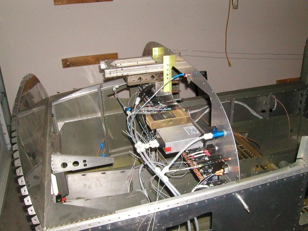

dlm46007(at)cox.net Guest
Posted: Thu Oct 25, 2007 7:43 pm Post subject: Static ports |
If you want alternate static air and have an EFIS, use a curtiss valve on
the panel into an AN female pipe thread T fitting. This will allow nylon
pipe thread to standard nylon lines into the static system. See attached
picture. See the valve to the left of the Chelton PFD.
Posted: Fri Oct 26, 2007 8:26 am Post subject: static ports |
check the blue fitting
