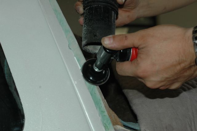

Ok, ok, ok, John. I will recount my experience in short. I’m in Ecuador right now and working long days, so don’t have much time to e-mail. The short of it is that I used a rubber mallet to break the pieces of plexi loose from the glue, as the middle of the windshield was already broken by whatever part of the Columbia hit it. It came off fairly clean, but not too easily. The weakest link in the system is definitely the polycarbonate to glue joint and the polycarbonate to fiberglass joint on the fairing, but it was a pretty strong bond. From there I just ground down the glue (the FE6026 stuff) with a die grinder with a sanding disk on it, cleaned up the glare shield again and started over with a new windshield.
Not a fun job.

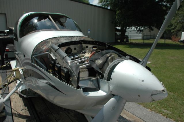

Jesse – thanks and any photos (when you return north) would help clarify the process. Mark are you game on your experience. Our goal is long-term and solid adhesion of the window material to the composite canopy through all types of flying experiences.
I guess too many builders are suffering from Acetone addiction for a Friday.
The attached photo was NOT acetone induced.

This is the best of what I have. Sorry for the mugshot, but it’s a little better than the alternative.

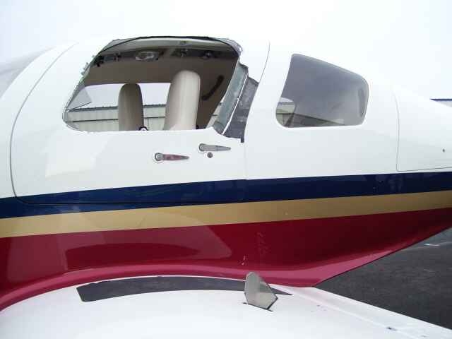

My front window came out surprisingly easy. Almost to easy. It came out in fairly large pieces. I had used a glue recommended by a Lancair builder. On the second window I used the Weld-0n 10.
Good turn out of RV-10's at LOE. I believe there were at least ten or eleven there. One unpainted RV-10 had a for sale sign with a $225k asking price.
