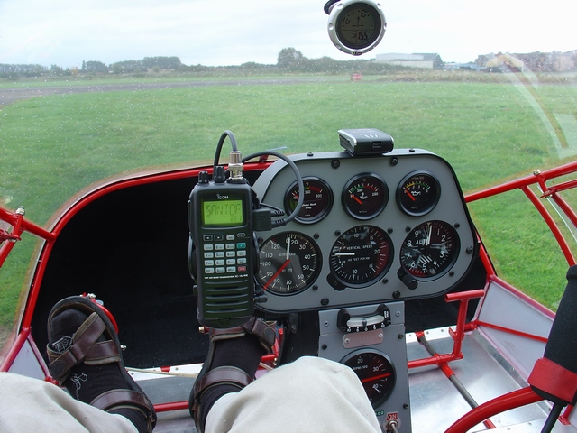

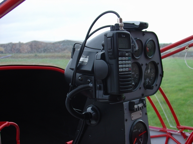

Hi Pat, I assume that you are using an Icom radio as do most of us here in the Uk, if so there is space to mount it on the left of the main instrument pod, mounted in this position it doesn't interfere with getting in and out of the cockpit, and also it is clear of your legs/knees when flying, in this position it is very readily accessible, if you need photos of how I did mine, post me your e-mail address and I'll send you a couple of photos.

j.codd(at)btopenworld.com Guest
Posted: Thu Sep 27, 2007 11:02 am Post subject: Space for radio mounting |
Hi Pat, I went down to Sandtoft Airfield today to do the first 25hr service/oil change etc on the 2200 Jabiru on my Mk3 Extra, as promised I took some photos of the radio/gps setup in my plane, as you will see the Icom Ic-A24E radio is attached to the left hand side of the instrument pod, this is well out of the way when getting in and out and also does not interfere when flying, the main support is a mobile phone mounting on an 8"flexible which has a suction cup for mounting to the console, additional support for the top end of the mount is in the form of a tie wrap attaching the top end of the flexible to the small metal plate on the left of the instrument pod (just slacken the two fixing screws a touch and thread the tie wrap through) tie wrap all cables and leads to the flexible support, works a treat, firm support for the radio and easily accessible, as for your previous enquiry regarding antennas, the Lynx short flexible VHF antenna works fine although we are getting better results with an antenna from Montreal, Canada, the Miracle Whip Antenna, this is a 1/2 wave diapole antenna against the Lynx's 1/4 wave, it certainly produces superior clearer reception, the manufacturers web site is j.codd(at)btopenworld.com (j.codd(at)btopenworld.com).
