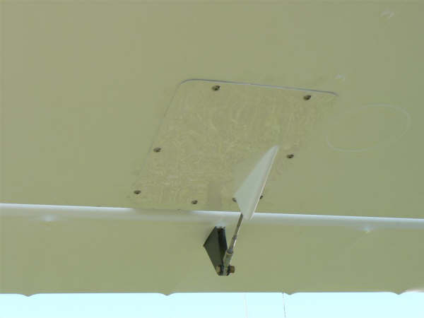

Group,
After recently recovering from a disease related to being an old fart, I finally feel like getting back in the shop, again, to work on my Kolb. A few months ago, I believe it was Richard (Neilson?) that took some photos at Sun 'n Fun of the new yellow Kolb MkIIIX. (which I have filed)
On this Xtra, it appeared there were aileron bellcranks and pushrods!!! Was this a standard conversion, from the Mk3C to the Mk3X, or was this a new mod TNK came out with recently? When I look at Mike's (Jetpilot) Xtra, I don't see those aileron horns. Anyone know the story or have a drawing (or photo) on this new design??
And, while I'm on the subject of ailerons. I have heard some people have balanced their ailerons. I don't seem to recall anywhere in my MkIIIC assembly manual, or plans refer to balancing the ailerons. Wut's up wit dat? (for those fluent in ebonics)
A few words of enlightenment would be greatly appreciated. Mike in SW Polygamy Utah

That is the end of a Morse cable.
_________________ John Hauck

You mean that photo of the aileron horn is also showing a "Morse cable?" As in a flexible type aircraft cable with a swaged fitting on the end? Oh!! Then I would assume there is one just like it on top of the wing, too. Yes?
Mike W.

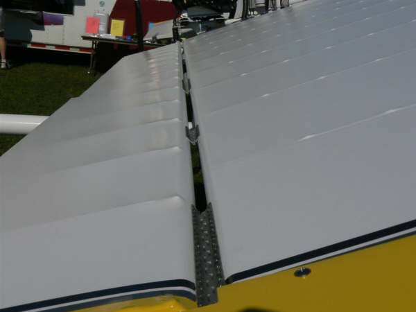

Hey John, I just checked the other photos and came up with this one of the top of the wing. It doesn't appear to have anything attached to control the top of the aileron. ??? Plus, a real close up vies of the "bellcrank & pushrod photo sure appears to have a heavy duty solid steel (?) rod attached to the heim bearing.
Is there any other people with new Xtra kits that have this feature, or is setup this just an orphan?? If it is indeed a solid rod, wouldn't that be referred to as a "push rod?" Again, this design looks pretty much the same as on my Cessna 172. As far as I knew, it was a push rod (from the bellcrank to the aileron horn). ??? Thanks

Ah ha!! After I sent off that last email, I went see what the "Morse cable" was built like. I see what you mean, John. The end of the cable has the solid shaft that attaches to the bearing. Oh. Mike W.
| Quote: | But, I was referring to the new style pushrods located out in the wing,
like my Cessna has. !
Mike Welch
Mike W:

Mike W:
A Morse cable is a push/pull cable. Only needs one. You know
like.........push and pull.
No, a Morse cable is a very stiff cable inside a flexible housing. They are
used for marine steering cables, also push/pull.
Mike W.

In a message dated 9/19/2007 7:17:51 P.M. Eastern Daylight Time, mdnanwelch7(at)hotmail.com writes:
| Quote: | Take a look see at the enclosed photo. (From Richard Pike, BTW)
It's also worth noting the beautiful Fairing/Inspection cover fabricated by Bryan Melborn.
