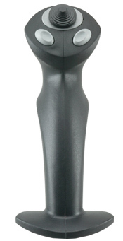

Hi Carl,
I have them in my 6A. They have worked well so far, I like the feel, and were fairly easy to wire. They have them set up for pilot and passenger sticks, make sure you get the correct one. I have one of each. I have it set up :- trigger - ppt; front - flip flop ( you need to watch this one, have changed channel without realizing it) - coolie hat Elev & Ail trim and Top two - auto pilot engage & disengage.

CJ
I’m currently using these grips in my aircraft but only have ~10 hrs TT at this point. I have had no problems or issues so far. Since these are gamer joysticks I assume that the contacts are rated for many-many operations. That is as long as you don’t try to run excessive current through them.
Good Luck
Bill

Carl
Joined: 04 May 2007 Posts: 44 Location: Aiken, SC
Posted: Tue Sep 04, 2007 10:38 am Post subject: CH Stick grips |
Thx Bill, I plan to order them, did you shorten your sticks to get down to Vans original height?

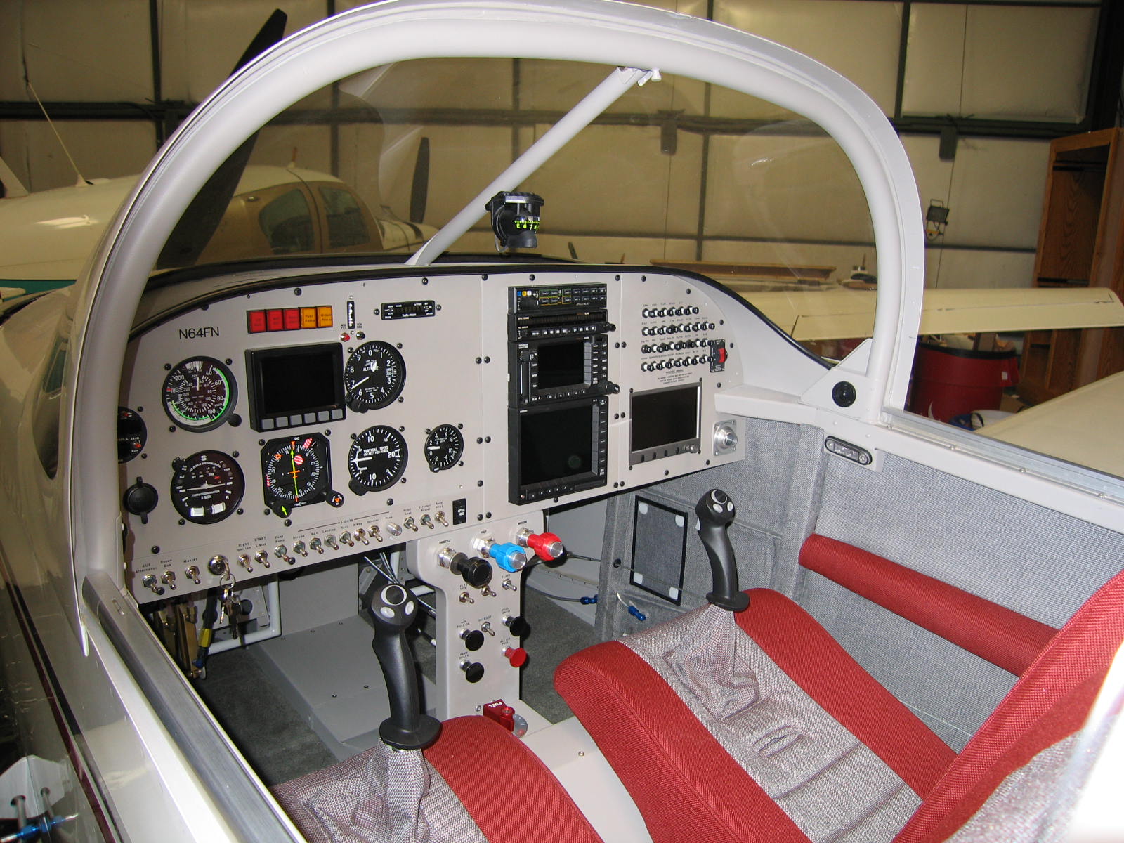

daverv6a(at)gmail.com Guest
Posted: Tue Sep 04, 2007 12:49 pm Post subject: CH Stick grips |
Tim,
I cut my sticks - don't remember how many inches - I have attached a photograph. I measured to make sure the grip didn't hit the panel and cut it there - I have the extended panel so it is a little lower than the standard one.
I generally fly with only thumb and 2 fingers, never a problem with control.
Dave

n616tb(at)btsapps.com Guest
Posted: Tue Sep 04, 2007 1:08 pm Post subject: CH Stick grips |
Hi Dave,
Nice panel! What is the glass clear over on the passenger side?
I fly with only my thumb and 2 fingers also except for take off and landing. At that point I move my hand completely up onto the stick as I was taught by Mike. It would seem to me that control would be easy enough obtained even if I cut a couple inches off but wanted to bounce it off of others.
Thanks for you input
Posted: Tue Sep 04, 2007 1:32 pm Post subject: CH Stick grips |
Hi Tim
Advanced Flight Systems - engine monitor - Just amazing piece of engineering.
http://www.advanced-flight-systems.com/
Dave

retasker(at)optonline.net Guest
Posted: Tue Sep 04, 2007 4:17 pm Post subject: CH Stick grips |
I don't yet have flying experience with the sticks, although I do have
two in my almost completed RV9A. The following email was posted in Nov
of 2004 regarding research I did on the switches used in the sticks.
Previous email:
There has been discussions about the CH Products control sticks (http://www.chproducts.com/retail/aircraft.html) on the newsgroups lately. I have two of them, but there was a question about what the switch ratings were. I contacted Kevin Williamson of CH Products and he was kind enough to supply me with a set of sample switches (from Omron) and the part numbers thereof.
I downloaded the complete data sheet from the web, reviewed the specifications and then called the Omron factory representative. There are a few minor errors in the datasheet available on the web, so the rep emailed me the revised (corrected) sheets. I also discussed with him the specifications listed and got clarification, although it turned out that when I received the revised data sheets, the specification is very clear now.
The bottom line is that the electrical rating for all three different switches is: 1-50mA, at 5-24V.
The explanation for the ratings is:
1. The lower values (1 mA at 5V) are to make sure that the switch sees enough energy when switching to keep the contacts clean. Any lower values would not guarantee that the contacts will always make proper contact over the life of the switch. If for some reason the load being switched is too low, a resistor could be added in parallel with the load to increase the current to at least 1 mA.
2. The higher values (50 mA at 24V) are the maximum values that should be switched that will not damage the switch. Switching any higher loads will risk damaging the contacts - either welding them shut or warping them or causing excessive arc damage - and will certainly shorten the life of the switch.
3. These ratings are for a resistive load, so if they are to be used with a relay or motor the contacts MUST be protected with a diode or other type of snubber network!
Of course, the manufacturer always has a margin in the design so if one chooses to switch 55mA at 14V (for instance), the switch will probably still have a reasonable life. However, pushing them to 100 mA or more will definitely shorten the life and may result in a catastrophic failure at some point.
These switches are rated for a lot of actuations so their use in an airplane should be no problem. The hat switches are rated for 300,000 operations (minimum), the switches on the top face of the stick are rated for 100,000 operations (minimum) and the trigger (typically used for push-to-talk) is rated for 1,000,000 operations (minimum).
To put these numbers in perspective, let's assume you make one flight every day for ten years. For each flight you could use the hat switch to trim the airplane 82 times in each direction, you could actuate the flaps (assuming that is what you use the two gray switches on the top of the stick for) 27 times each up and down and you could push-to-talk 274 times.
