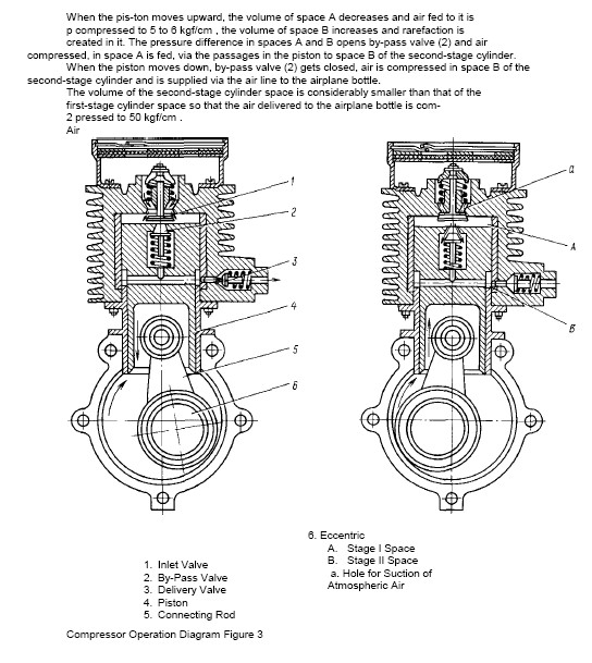

I appreciate all the input. I'm attaching a diagram of the compressor for those who are following but don't have one at hand.
Compressor AK-50A

And we always thought the USSR were inferior and simple minded! It has been
awhile since I looked at the diagram but danged if it is not complicated!
