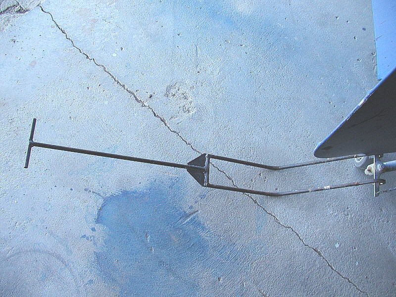

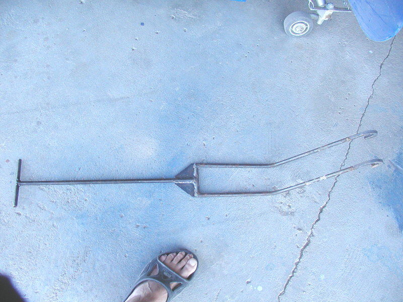

Pat,
For some reason I didn't get your message on the forum, I saw R Pike's
message and went to the BB to see what he was talking about. I just made
a
deal to hook on the tail wheel to pull mine where I want. The foot is in
the
picture to give perspective. The deal is made from spare cro moly tubing.
The bent parts on the end are solid steel bent to that angle and welded
into
the end of the tubes. The bend is there so that it does not contact the
tail
when I am dragging the plane backwards.
Larry C

Hi Larry,
thanks for the pics. Very neat contrivance ( and what neat feet you have
Grandma !).
Your design would be great if I had a flat floor and just a slope to pull
the plane up but I would hesitate to apply to the tail fitting the force
that I need to shift mine.
