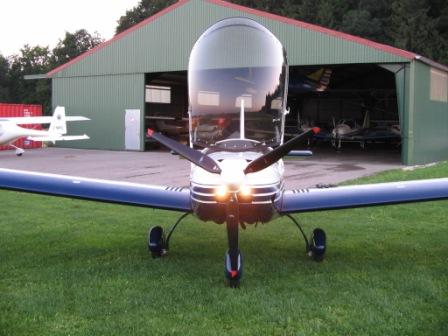

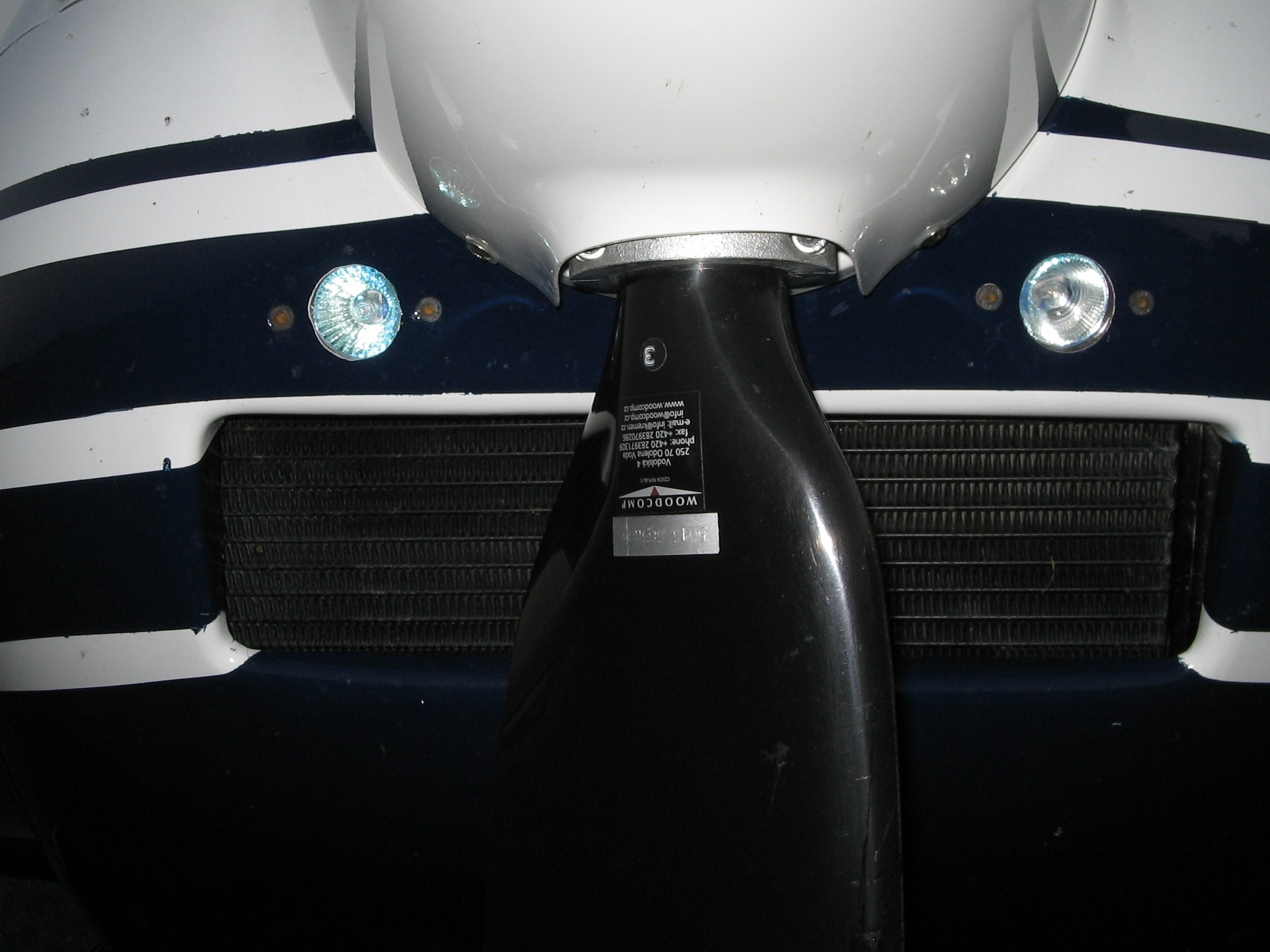

on this subject i mounted 2 12volt Halogen lights in the lower engine cowl good light (also possible to go for LEDs) and very light. housing for lights was made from Acrylic Plastic.
