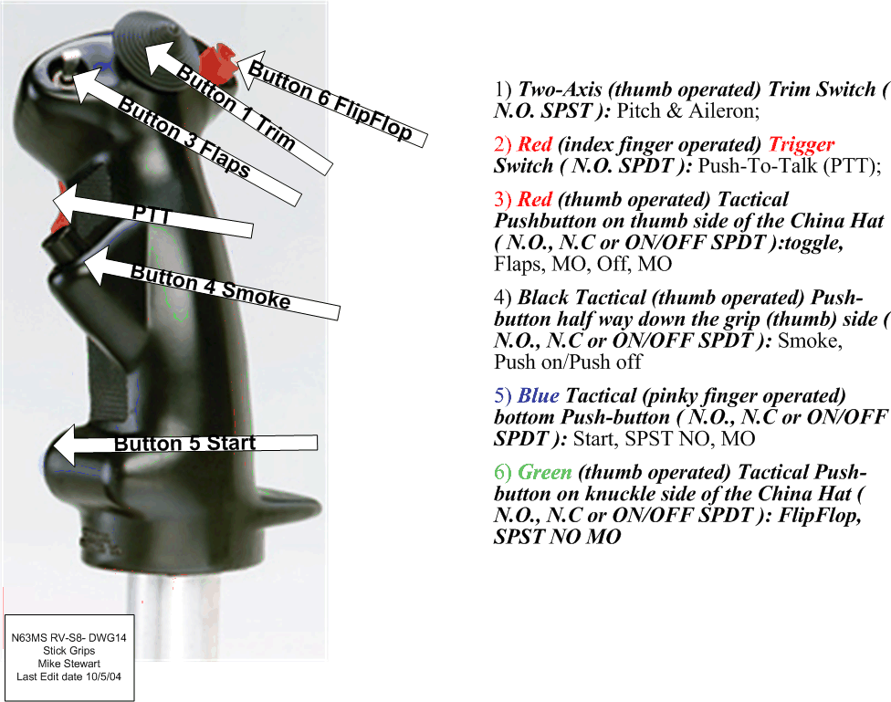

Don't know if the pdf attachments will go through. All of the information is on the website, though. Once you go through the diagrams it all begins to make sense. If you can't get these, mail me off line.
Love this grip!!

It's not a diagram, but it does show all the possible switch configurations and wire colors. You can easily verify the wires to the correct switches with an ohmmeter. I printed it out and highlighted the switches and wire colors for easy ID.

They are made to order and should come with a diagram. Get out your ohm meter
and do a little testing and it will all make sense. Some of the switches are momentary, some are normally open some are flap switches some are....well you get the idea. If you contact
them you may find he has a record of it and can send/fax you a copy.
