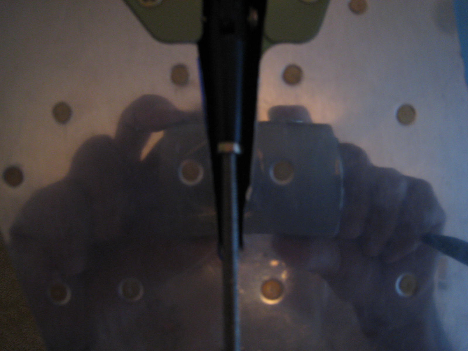

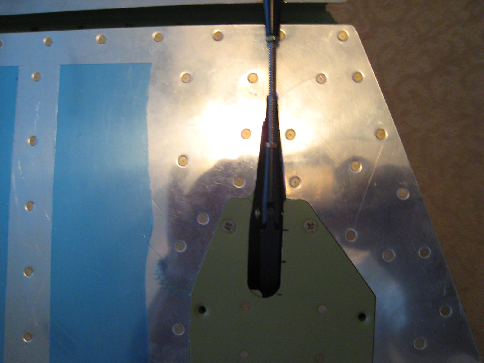

Hi folks!
I would appreciate some help. I’m trying to rig up the electric trim and find that I need to trim away quite a bit of metal to eliminate interference for the full down trim.
I followed Van’s instructions regarding the positioning of the trim motor mount. As you can see from the pictures, though still within the opening footprint,
the actuating rod turned out pretty close to the inboard edge. (I thought about centering the mounts at the time, but decided to trust the plans.)
After installing the trim system, there is a slight miss-alignment, but nothing that would cause stress in the system. I made some marks on the max, min, and half-way travel of the actuating rod. I then adjusted the length for no trim at the half-way point.
What worries me most is the amount of metal I have to file out to prevent the actuating rod from contacting the elevator under max down trim. As you can see, I’ve already removed quite a bit of Aluminum. I hesitate to trim further without some reassurance.
Van’s builder’s assistance is closed for the weekend, so I thought I would seek y’alls’ help (I recently moved to Aiken, SC, and I’m learning the local grammar )
Thanks and best regards,
Rafael

Dear Rafael,
I had the same problem, till a more experienced builder told me to put a bend in the threaded rod.
It will lift it just slightly and should give you a little more breathing room.
Hope that works for you. Sorry I don't have a photo close by to send.

Thanks!
That makes a lot of sense. It’s definitely less traumatic than removing al that aluminum.
I’ll try it.

Thanks again, John for your suggestion.
I bent the rod a few degrees and that worked very well. It not only gave me good clearance, but I was also to correct for the slight miss-alignment.
I now have another question: I measure a trim control of 20.6 degrees up trim max. and 23.2 degrees down trim max. Van’s figures, on section 15: Flight Controls, call for Maximum up/down of 25-35 degrees. That implies to me that a minimum travel of 50 degrees is necessary. I’m getting 43.8 degrees, so there’s no way to meet these numbers. It’s all that the motor actuator will give.
Any comments as to what’s going on?

Posted: Wed Aug 08, 2007 9:52 pm Post subject: Elevator trim rigging |
Rafael:
I just got back from a trip and saw your question about the trim travel. I measured mine today and it is very close to your measurement. I have 20.3 up trim (down movement of the trim tab) and 24.8 down trim (up movement of the trim tab) for a total of 45.3. As I recall from the last RV that I flew you use very little of the trim tab to adjust for approach speed and curse. I see no method of getting more travel without changing the trim servo. Maybe someone else has a method to get more travel from the servo.
good luck
dave
RV 7A
Starting on the cowling
Thanks and regards,
Rafael
From: owner-rv7-list-server(at)matronics.com [mailto:owner-rv7-list-server(at)matronics.com (owner-rv7-list-server(at)matronics.com)] On Behalf Of RafaelSent: Friday, August 03, 2007 10:58 PMTo: rv7-list(at)matronics.com (rv7-list(at)matronics.com)Subject: RE: Elevator trim rigging
Thanks!
I’ll try it.
Rafael
From: owner-rv7-list-server(at)matronics.com [mailto:owner-rv7-list-server(at)matronics.com (owner-rv7-list-server(at)matronics.com)] On Behalf Of J. BrunkeSent: Friday, August 03, 2007 11:04 PMTo: rv7-list(at)matronics.com (rv7-list(at)matronics.com)Subject: Re: Elevator trim rigging
Dear Rafael,
John Brunke
RV7 in progress

Yep, my RV-7 needs VERY little trim changes through the full speed range.
Mike
RV-7

rafael(at)gforcecable.com Guest
Posted: Thu Aug 09, 2007 3:26 am Post subject: Elevator trim rigging |
Thanks!
That’s what it is and it looks like it will do fine.
Cheers,
Rafael
RV7A Just finishing the empennage.
