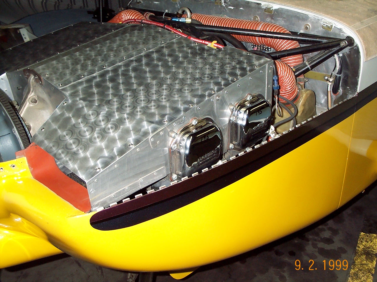

PostPosted: Tue Jun 19, 2007 6:23 am    Post subject: 50% loss say some Reply with quote
Mike...
I made a enclosed plenum around my engine and lost about 25 degrees of CHT
temps... The temps dropped from 375 average to 350 average... Those are
good numbers... Picture attached...
Best... Steve
