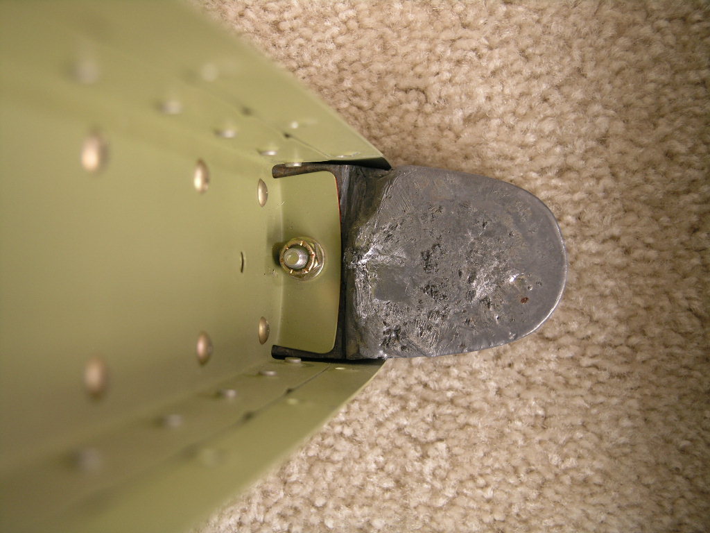

I too found the lead weight to be too light after installing the pitch
trim servo. To correct, I clamped a piece of sheet metal around the
weight as a form and used a small propane torch to get the center of the
weight molten to within about a 1/4" of the edge, then added lead using
large fishing weights. The weight is just a little heavier than
necessary and will trim as required after painting. Attached are three
pictures comparing the "as is" right elevator weight to the modified
right elevator weight.
