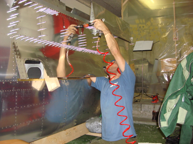

I riveted the botom wing last monday and its takes a full day but it works. YOu can check the quality of the rivets if you press the finger on the shop head (the one you made) and compare the imprint on your finger with the gauge if you can“t reach in.
YOu might find yourself in a little arkward position when riveting the rear spar, see picture.
Michael
