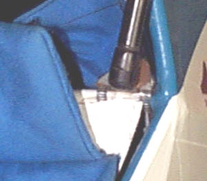

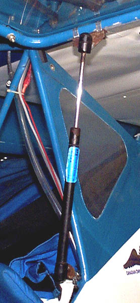

Ok now I have the pictures.
The installation was done with two small pieces of angle. I used some metal (about .032") which I bent into angle. The angle is is held to the cross tube behind the pilot and to the frame of the back of the door. I put the strut on the back of the door because I fly floats and have to enter from the front. The angle extrusions are slotted With a Dremel tool right at the angle to allow them to be mounted on the tubes with small gear clamps. Every thing is out in the open where it is easy to inspect. Surprisingly none of the four gear clamps have loosened at all. The brackets have a hole drilled in them which the ball end of the two ball and socket ends is bolted through.
The height of the bracket on the door is important. It should be higher than the distance of the lower bracket form the door closed position to give an over centre positive close to the door when the door is pulled down.
The position of the door bracket is set to allow an almost a full closure of the strut while closing the door.
This strut is 9 in. long, 10.5 in over all and has the ball and socket joints with the balls at both ends. I got this strut from a local salvage yard and have no idea what it came out of. I'm sure you can find the complete unit at an automotive supply shop if you don't have a salvage yard you can browse.
[img]cid:303392322(at)20042007-2BF0[/img]
The next picture is a close up of the bracket on the cross tube. It strut ball is mounted far enough into the plane so as not to interfere with the operation of the door.
[img]cid:303392322(at)20042007-2BF7[/img]
I put this on my door as occasionally I like to fly and always taxi with the door open. If the salvage yard had two of these struts I would have installed both of them. It has worked well for the past year or so so I guess the next thing to do is paint the brackets to make them look as if they belonged there.
I'm far from a fortune teller but I do see another trip to the salvage yard for me in the near future.
Removing the door is easy as there is a little metal clip that holds the socket of the strut over the ball. I just have to make sure to keep the clips with the strut.
Clear as Mud??

p.s. The installation of the struts is a lot cleaner if using the pre-
made parts probably available from John McBean. My parts came with my
kit. The mounting "angles" are actually a piece of tubing with the
mounting flange welded on (you can make these if you can weld), then
cut lengthwise. The roundness of the tubing gives a better contact
with the door frame.
The position of the door bracket is set to allow an [b]almost[/b] a full closure of the strut while closing the door.
Clear as Mud??
Noel
